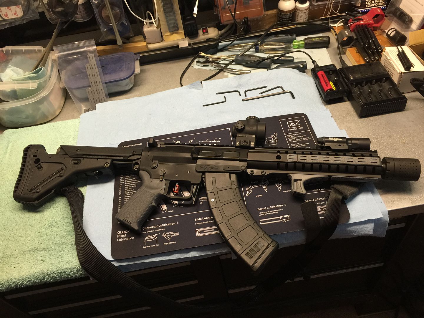

I run a Magpul UBR on mine. The buffer tube is standard AR15 carbine length, so any stock that uses a carbine milspec buffer tube will work. The Buffer and spring are designed for the rifle.
Thanks everyone for your replies. I noticed Irunguns has a pistol version the MK47K. Would I be able to add a stock to this version and have a 10" MK47 rifle?
You will have to replace the buffer tube with one that allows for adding a stock (re: adjustment slots, etc).
The buffer and spring are unique to the rifle and can be put into the mil spec (recommended) buffer tube you put on the rifle.
Ok, good to know. I wasn't sure if it used the same buffer tube as an AR-15, in the video I watched the bolt and carrier looked larger than an AR-15 and smaller than an AR-10. Diameter of the buffer must be the same while other dimensions are changed.
