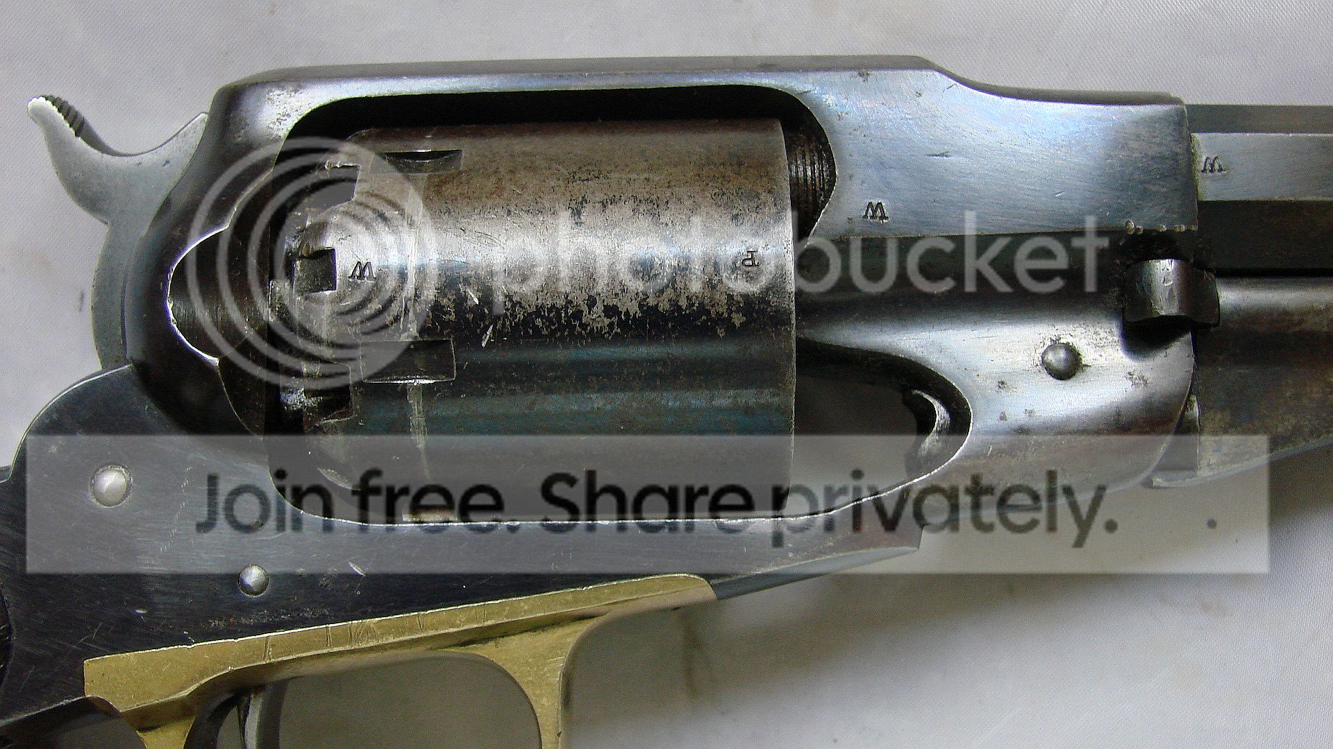

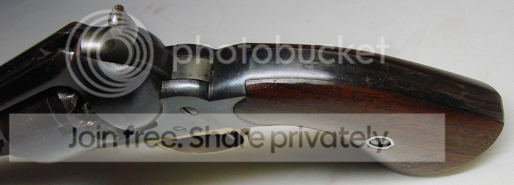

I am sure that many will disagree with me.
Back in the early 70s my Father and I shot the two revolvers shown below, I cringe when I think about it now.
These are original guns and I am sure original blueing was lost in the process.
In my mind the reproduction versions are meant for shooting not the old guys.

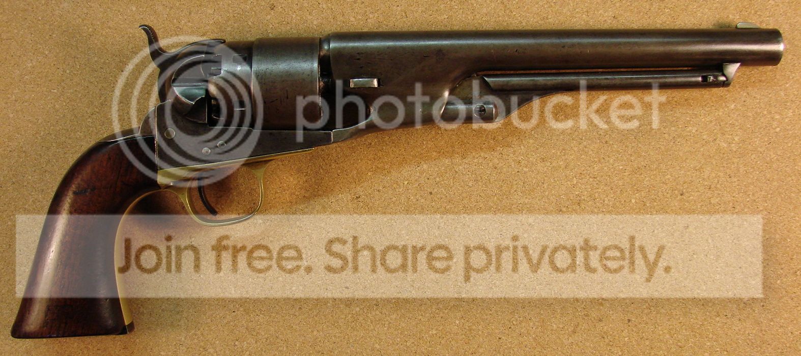

I guess I should further qualify my answer....it all depends on the condition of the gun and the degree of remaining original finish.
I would probably shoot this 60 Army.....if I was inclined to shoot an original Model 1860.
I would not shoot this one.

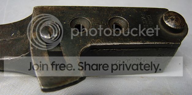

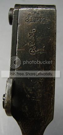

I have a Colt .31 cal bullet mould but my 49 Colt is not cased.
Your gun is cased.
I don't know if the case and accessories are original to the pistol, but that sets it apart from just a gun by itself.
