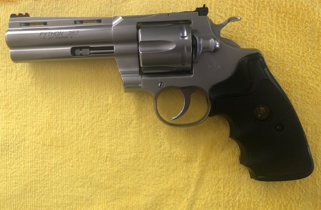

So I was doing some research on revolvers, mainly Cylinder lockup.
I already know that the newer s&w and rugers locks at the cylinder release and at the crane, while the olders s&w lock at the very end of the ejector rod with a ball detent.
That's fine and all, but what about the Python?
I see it locks and the cylinder release like all the other revolver, but that's it.
I really can't find anywhere else where it would lock, except the cylinder stop of course.
Any insight on this? My Google-jitsu was fruitless.
I also heard there's another way it lock as I read the cylinder stop "drops" right when the trigger is pulled..
But the way I see it, the stop is already in place when the hammer is cocked, so does it drop deeper or something?
