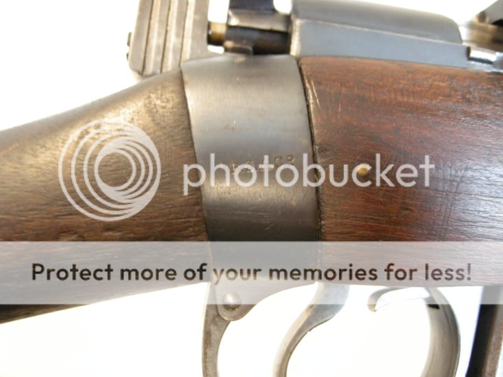

I've owned a very nice undated BSA made MkIII for some years which appears to be a commercial sale rifle as it is devoid of military property marks, but has the usual BNP proofs. The s/n is 3 digits-E-5digits. The bolt is matching with the last 5 digits of the s/n. The s/n markings are all original with no overstamps or crossed out characters. The receiver ring is engraved with a previous owners name and "Winnipeg" in jeweler's style engraving. The rifle is in stock condition and is very accurate. It has a cutoff installed.
I've never stripped the rifle to check for other markings, nor do I plan to. The absence of military markings plus the engraved name on the receiver suggests that this piece may be a commercial sales rifle which was purchased by a civilian target shooter. I can't find anything helpful in the Skennerton or Stratton books, but the "E" in the s/n suggest that the receiver may have been made in 1917. This is interesting because I understand that BSA was only producing MkIII* receivers in 1917. Anyone have any expertise in this area?
