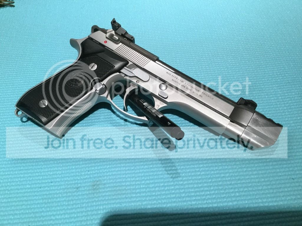

Had a beretta custom with a comp barrel...didn't really notice much difference with it on...an all steel pistol with good balance shoots pretty softly anyway...imho
