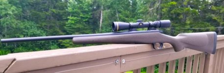

The rifle is on the bag and other than my hand on the trigger there’s nothing touching it.
