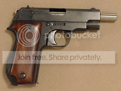

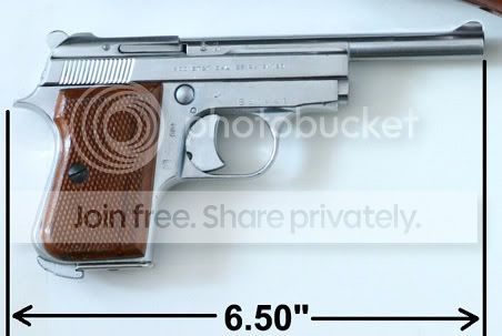

I have done a few conversions using the original barrel. (I only do my own guns) I drilled out the rifling, added a barrel liner, re-chambered, and added a cover piece over the extended barrel liner.
Older guns tend to have thicker barrels compared some more recent models. It gives you something to work with.
