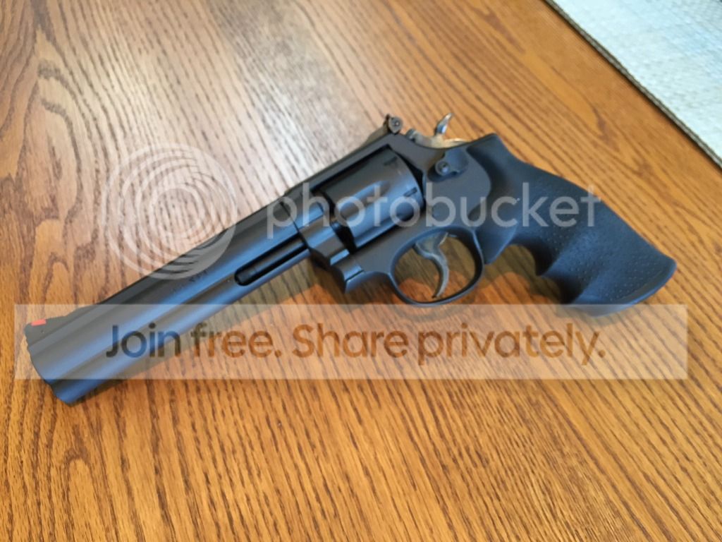

Murray told me he cannot obtain the model 14 barrel in 6". The Smith & Wesson gunsmiths themselves told me on the phone there are none left. The Model 15 I posted about is now being re-barrelled with a new 6" 586 barrel ordered from S&W.
Sorry, but that took a while. Had the work done. See pic, which I hope I have attached correctly.

That looks really, really good! And you've got a shootable, one-of-a-kind revolver that is a great way to celebrate your friend.
