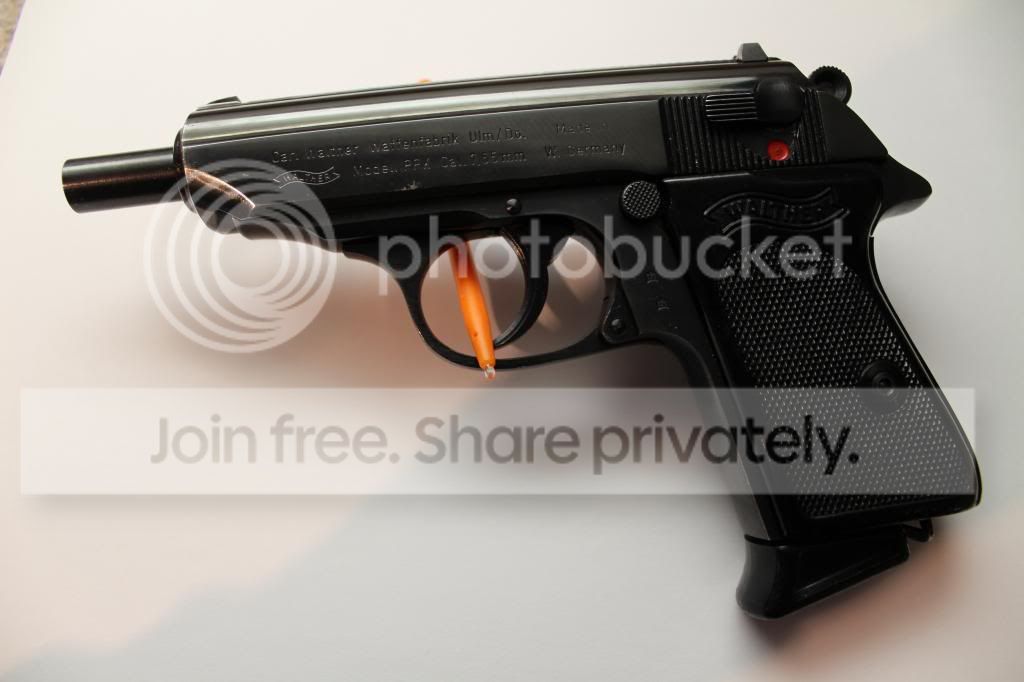

I've had a couple converted to sell. As stated a PP looks better with a "legal" barrel than a PPK but all in all the PPK still looks cool.
I was told by the smith we couldn't thread the barrel because the end result would be a weakened barrel....too thin.
Someone will correct me but all conversions other than Epps 30 Reid become 380....32 is prohib. Converting a 32 to 380 creates issues....tight tolerances I believe.

Ya, the barrel sticks out but beats not having a ppk...
Get a PP instead and the barrel only stick out !/4" or so. That looks like an abortion
