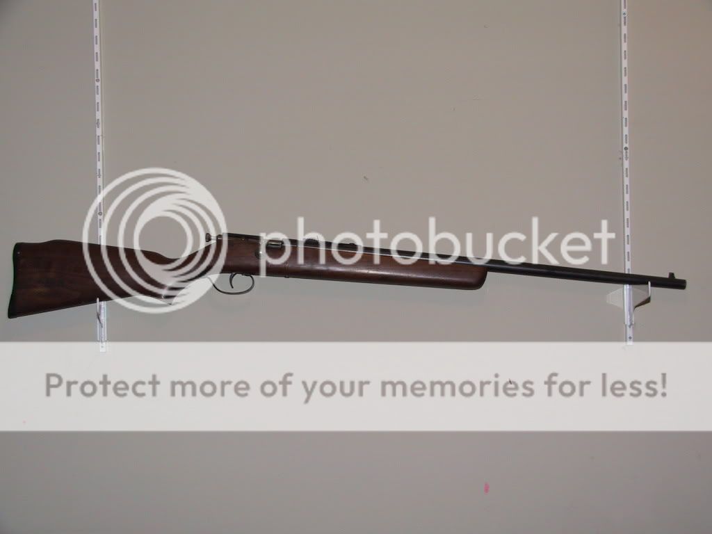

Looks great! I was just looking at my model 82 and wondering what to do with it. A shortened barrel and cut down stock is a great idea.

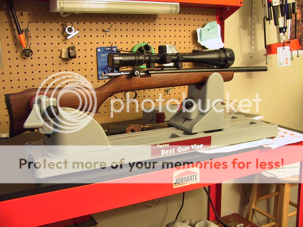

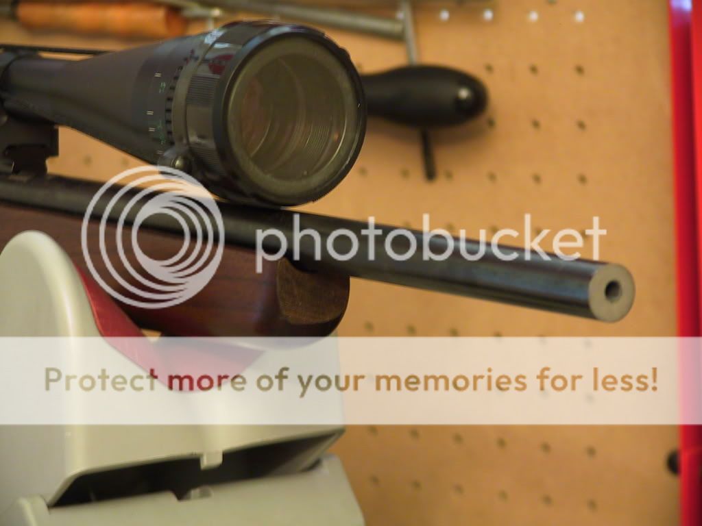

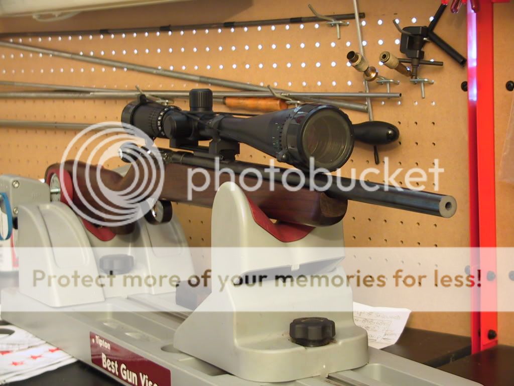

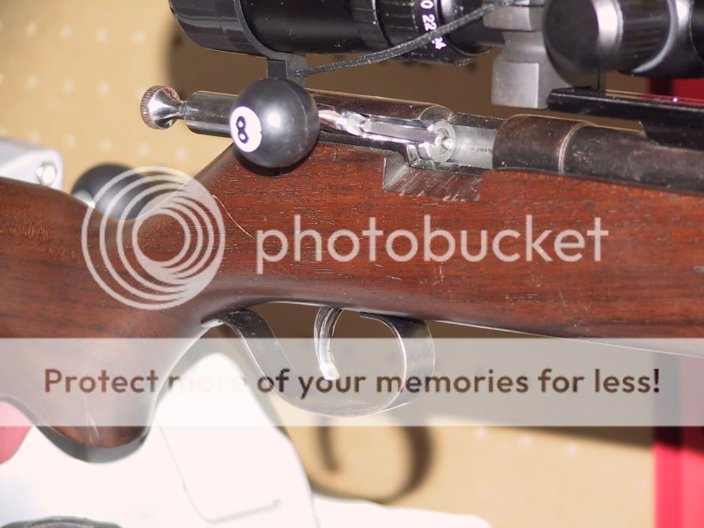

How did you re-cut the fore end of the stock? I'd like to do that on a rifle of mine, but I don't know how to do it level.
I wanted the cut to be square to the barrel channel so I just layed the stock,channel down,on the table saw and took off small slices untill I was happy. The nose of my stock was not an even radius,it is a Cooey after all, so I just took it back until it looked half a$$ed right and said good enough.
That's awesooome :D

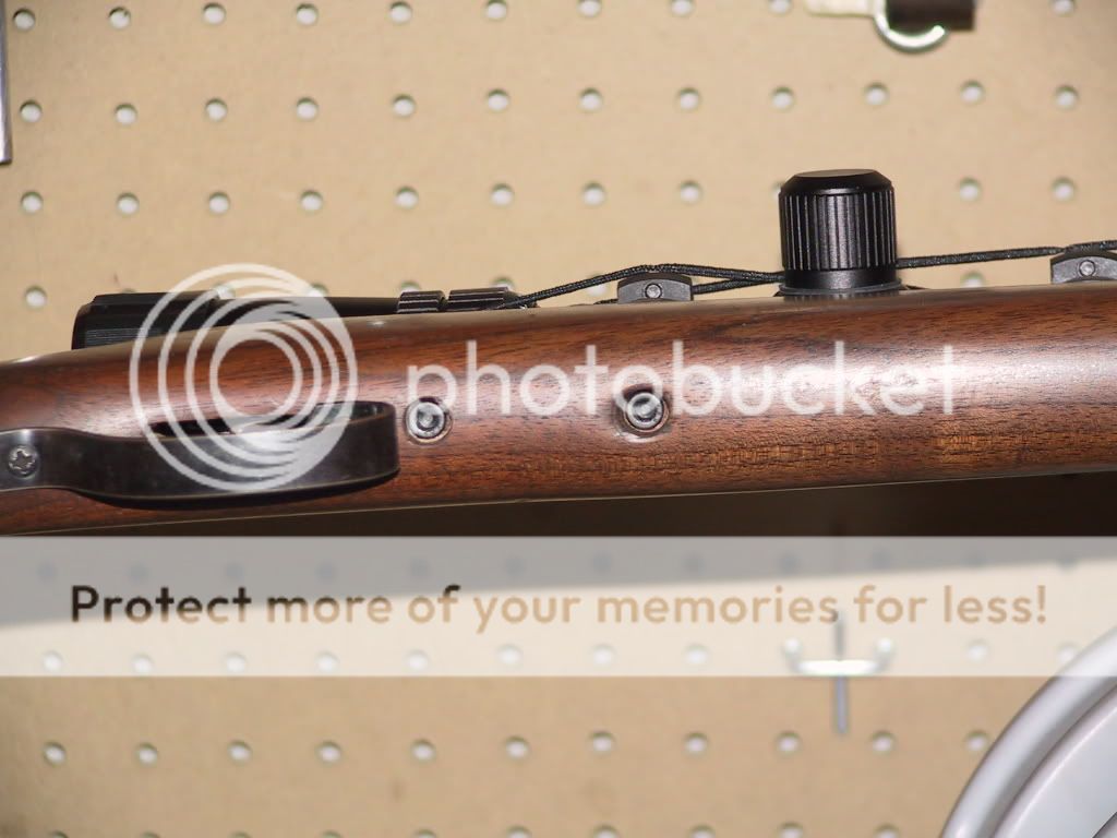

how did you do the 8 ball?
Thanks Guppy. The 8 ball is actually a shwinn bicycle valve cap that I picked up at liquidation world for .88 cents(a pair). Oddly enough I had an insert in my box o' crap that was the right thread and slipped into the cap perfectly, I have no idea where it came from. The paint on the 8 ball wore off after a day or so of gopher sniping and has since been replaced with a knob from a set of BM20 hydraulic levers, again using the same insert as before.

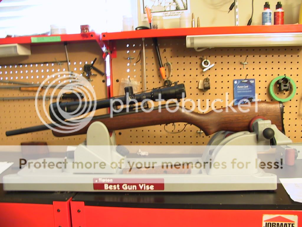

A quick update. The stock has been re-finished and looks awesome. I have made several attempts at bluing the metal with different products but nothing seems to want to take. I think slow rust bluing might be the answer but I'm still looking into that.
