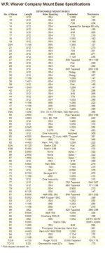

not 100% certain, but try a weaver 24 for fit, the receiver should be close in diameter to a savage mark 11
kamlooky - not sure where I got this chart - maybe from Brownell's at one time - some dimensions of some Weaver bases - seemed to work out to be correct the several times that I have used it - fourth (?) column shows the diameter of the particular base - the underside of it - you would start by measuring your receiver - that diameter or a smidgeon smaller - if a bit smaller, will be only touching on two bottom edges to receiver, but likely flattens out to full contact once screws are snugged up - fairly "redneck", perhaps.
