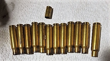

After 8 hours in corn corb media, old 7.62x51 DA & IVI cases still look crappy.
3 Hours with pins should have done the job.
8 hrs corn cob.
Then 3hrs SS pins
7.5x55 on the right
