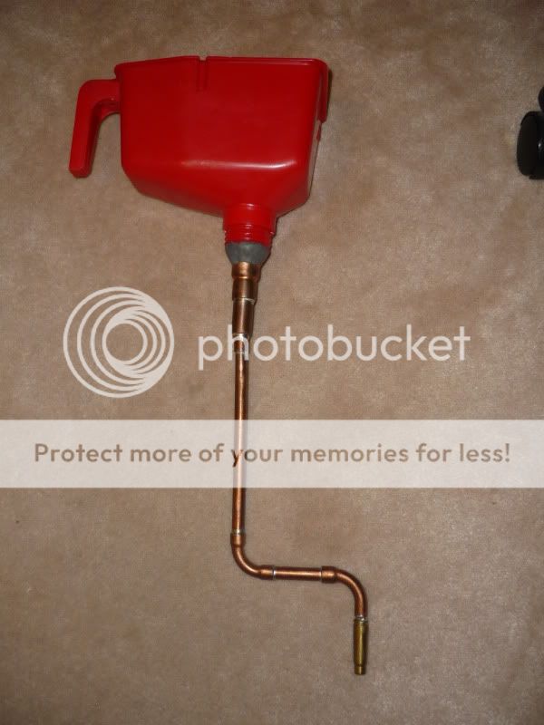

Hot Water +
It makes flushing the bore, etc, very mess free :).
nice device but i believe corrosive wont be confined to the bore alone so some water spillage around the chamber is OK . i use a kettle .
