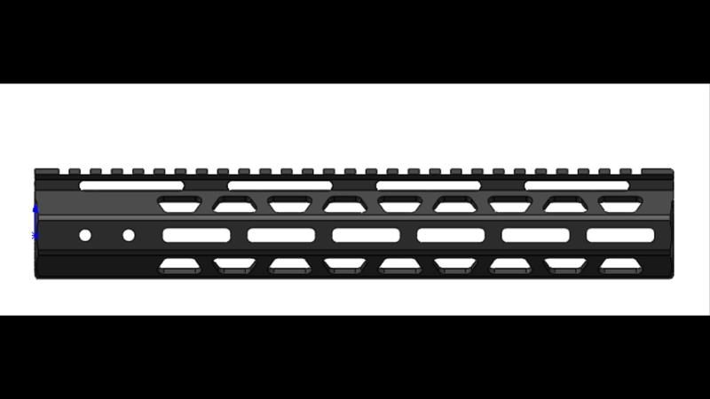

One of our suppliers has indicated that we can get in on a production run of white label M-LOC rails. Before we jump in, I just wanted to get your feedback.
Essentially we can get the above rails in 7", 10", 12" and 15"
Each of the rails includes 2 mini rail segments and barrel nut for free
The weight is expected to be roughly as follows
7" 165g- 274g
10" 185g- 337g
12" 216g - 390g
15" 267g- 456g
The cost is expected to be roughly as follows
7" $93-$103
10" $101- $111
12" $107 - $117
15" $115-$125
The problem is we need to order in increments of 100.
Delivery would be late December or early January
What are your thoughts?
Wanna do a group pre buy to help us out?
Looks fantastic,but can you elaborate on how it's secured to the barrel but?
I've seen some pretty terrible methods of attaching them.
For that money I would order a 12" rail, just to have on hand for a future build, depending on, like the poster above mentioned how is it secured.
That sort of nut requires tabs on the handguard or some other method like the NSR pin to ensure the whole nut/handguard assembly doesn't rotate.
It also should come with shims so it can be timed correctly.
our other rails using this technology from this manufacturer include 4 shims for setting the timing
What method for preventing rotation?
They can likely be pinned like a noveske through the dowel hole if you wanted to drill your upper
This picture is one of our light weight rails. It looks like the same extrusion to me
