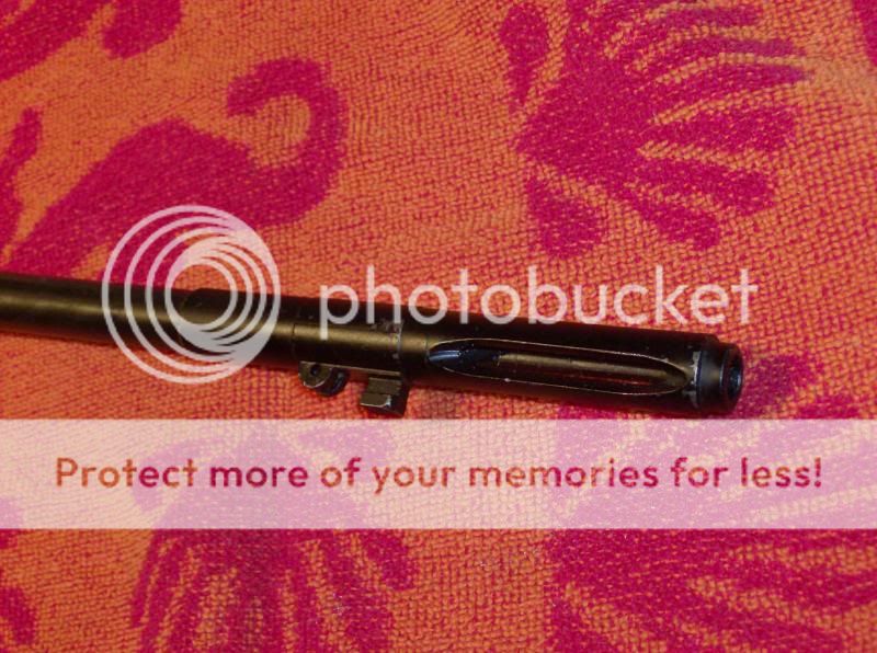

So I started with dressing up the front. CGN's Airborneboi69 already installed a FN flash hider on a SKS for me (no worries, that one also super bubba'ed before I put my hands on it), and so he was perfectly qualified (and skilled, that he is too) to repeat the operation. Well done again, Arborneboi69.

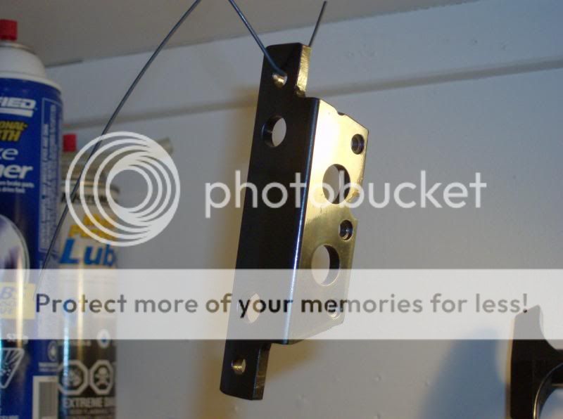

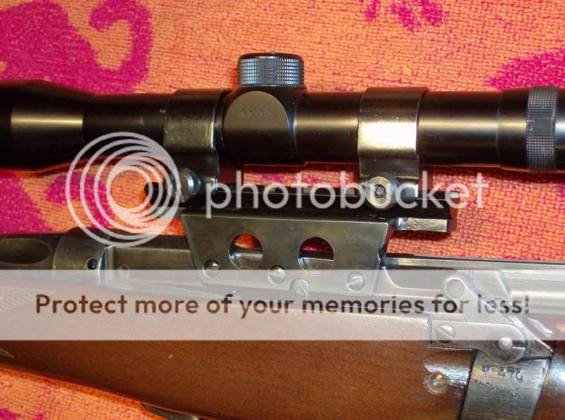

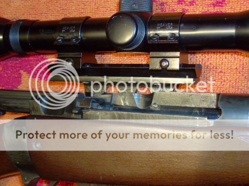

Then, I wanted to mount a scope on this rifle, because, well, a sporter deer rifle can use a scope. So why not try to make one, but one that won't look too much like a big chunk of angle iron once I'm done. Yeah, but starting with a big chunk of angle iron is easy. So that's what I started with. Rusted junk from the garage. I did spend quite a bit of time with my angled grinder, bench grinder, belt sander and drill press to end up with this object.
I slipped a few times with the grinder so there are some "oopsies" on it, but hey, it's a first attempt at it. I am learning. I installed some generic Picattiny rail on it, and there you go, scope mount.

Thanks guys. I forgot to mention that the charger bridge had been long gone as well. There wasn't a lot of metal left on that poor receiver.

The mount seems to sit a wee bit too low for using iron sights; but since there's no front sight... Although I thought about it. Chose to make the mount low-ish so that the scope isn't way out of reach.

It's a good thing that rifle found you, louthepou. With the charger bridge and rear sight mount area milled off I wouldn't have imagined anything worthwhile could have been done with it and wouldn't have bothered trying.
I've got to do basically the same thing coming up. I wonder if a dado cut down the length of the mount would allow the retention of iron sights.
Looks really good. I really like the FN flash hider. I have a bubba'd No.4 with an 18-1/2" barrel I would like to do that to. But I have heard, and this could be completely wrong, that some of the FN flash hiders will split open. One of the site sponsors sells them dirt cheap.
