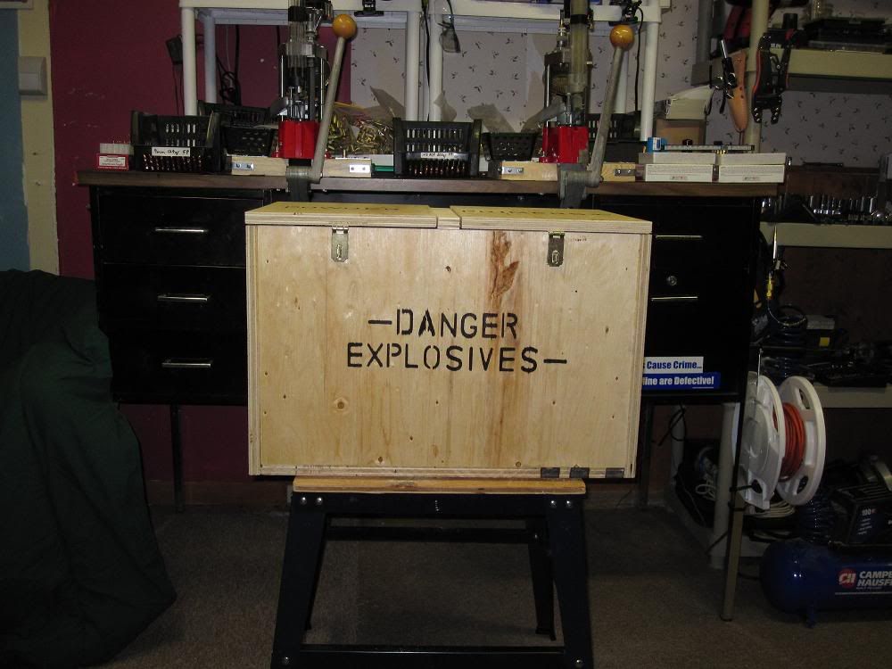

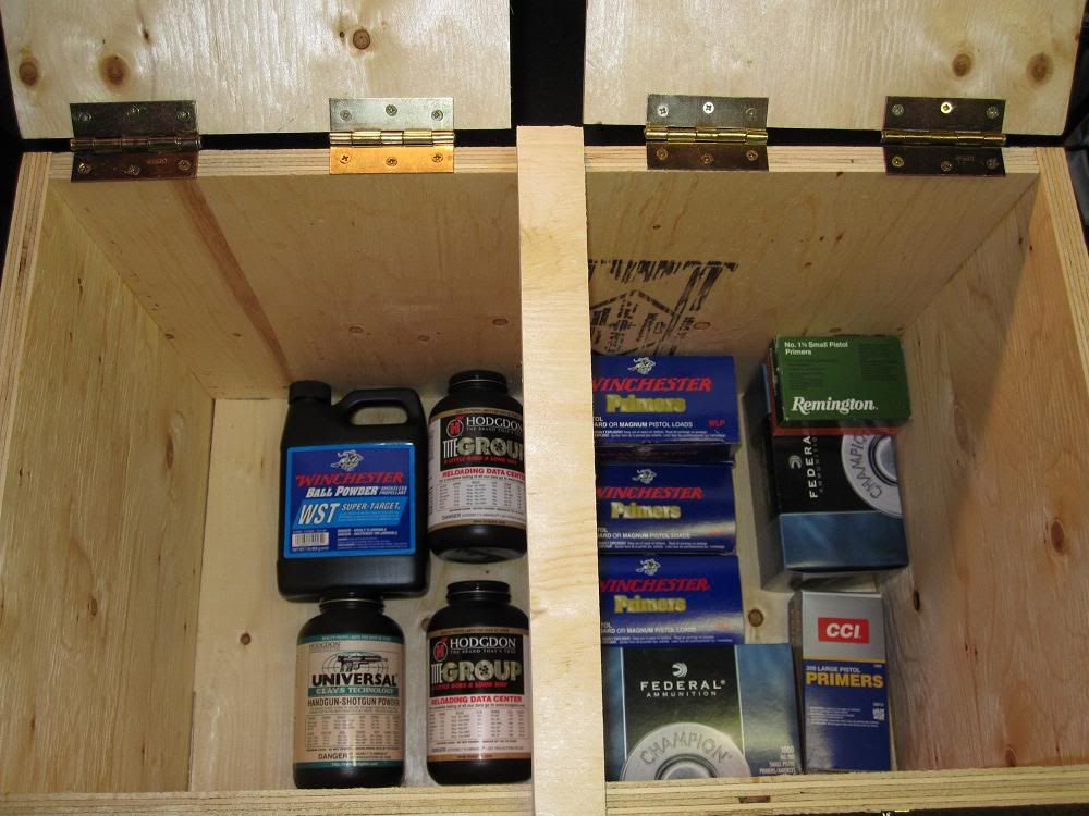

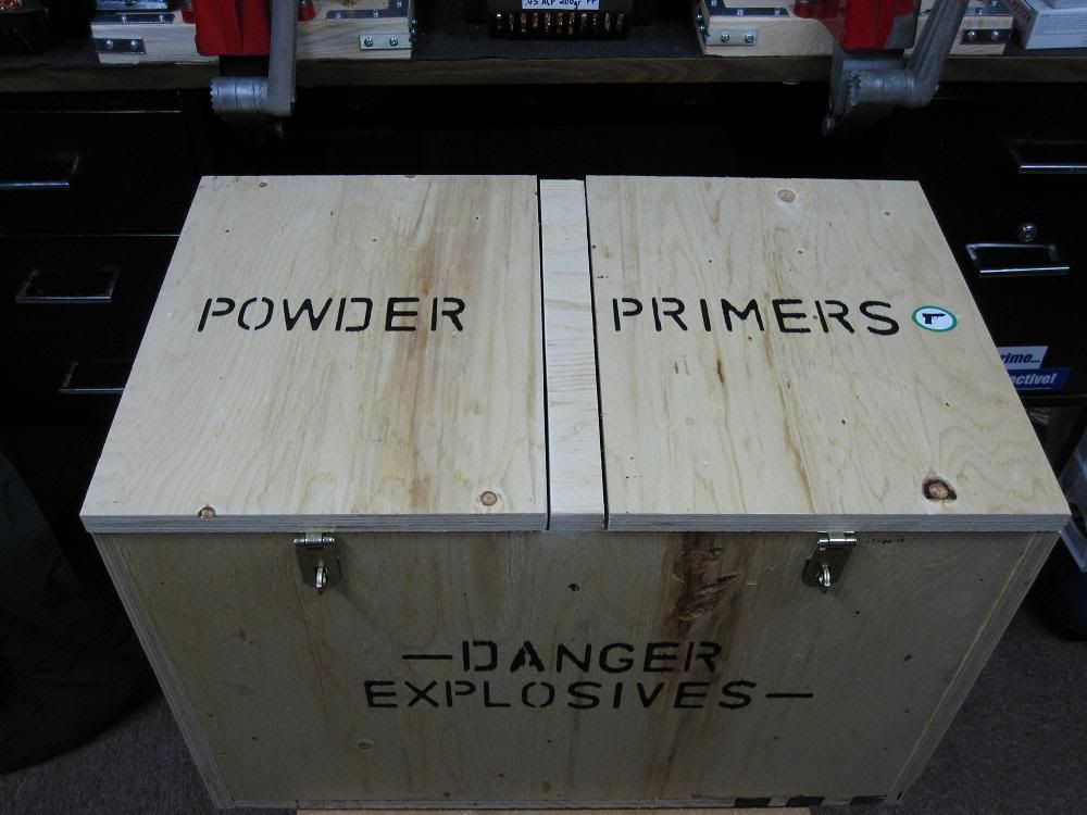

I couldn't sleep last night. I already had the wood cut for a new powder and primer storage box about three months ago. LOL I constructed it with only wood, glue and brass. No sparks possible. Was fun to finally finish it.....
Seeing the first pic I expected to see an inside shot with those scoops you see in bulk food bins, lol.
Seriously though, nice job. I have all the brass hardware, just have to get off my butt and build one.
Nice job. I'd love to build one, but I don't feel like spending $100 on plywood to make it big enough. WHO SAID HOARDING !!! :D
This is actually my tenth box of the same size!....................
Just joking. I haven't been reloading for too long. Just 9mm and .45 so far. Just bought a hunting rifle so looks like I will be filling up my box quickly.
Very nice job, I have 2 boxs I made but not as nice as yours, think I should upgrade. Just curious, does the box have to be a min of 1" thick?
That is the recommendation from the CSSA(actually 3/4")....
The storage of gun powder is regulated by the explosives act, r.S.C. 1990. you may keep a maximum of 12 kg. In a dwelling if it in a suitable container. this is specified to be a box of 3/4 inch thick wood, no ferrous fittings (use brass, bronze, or glue), be locked and labelled aexplosives@. only 2 kg. Can be out of the box at any one time to be used. this means that when you are finished reloading you must return the unused powder to the locked box. the ministry of energy mines and resources recommends that anyone who contravenes this be charged under the criminal code with unsafe storage of ammunition. to the ministry there is no distinction between black powder and smokeless powder. primers are to be similarly stored.
