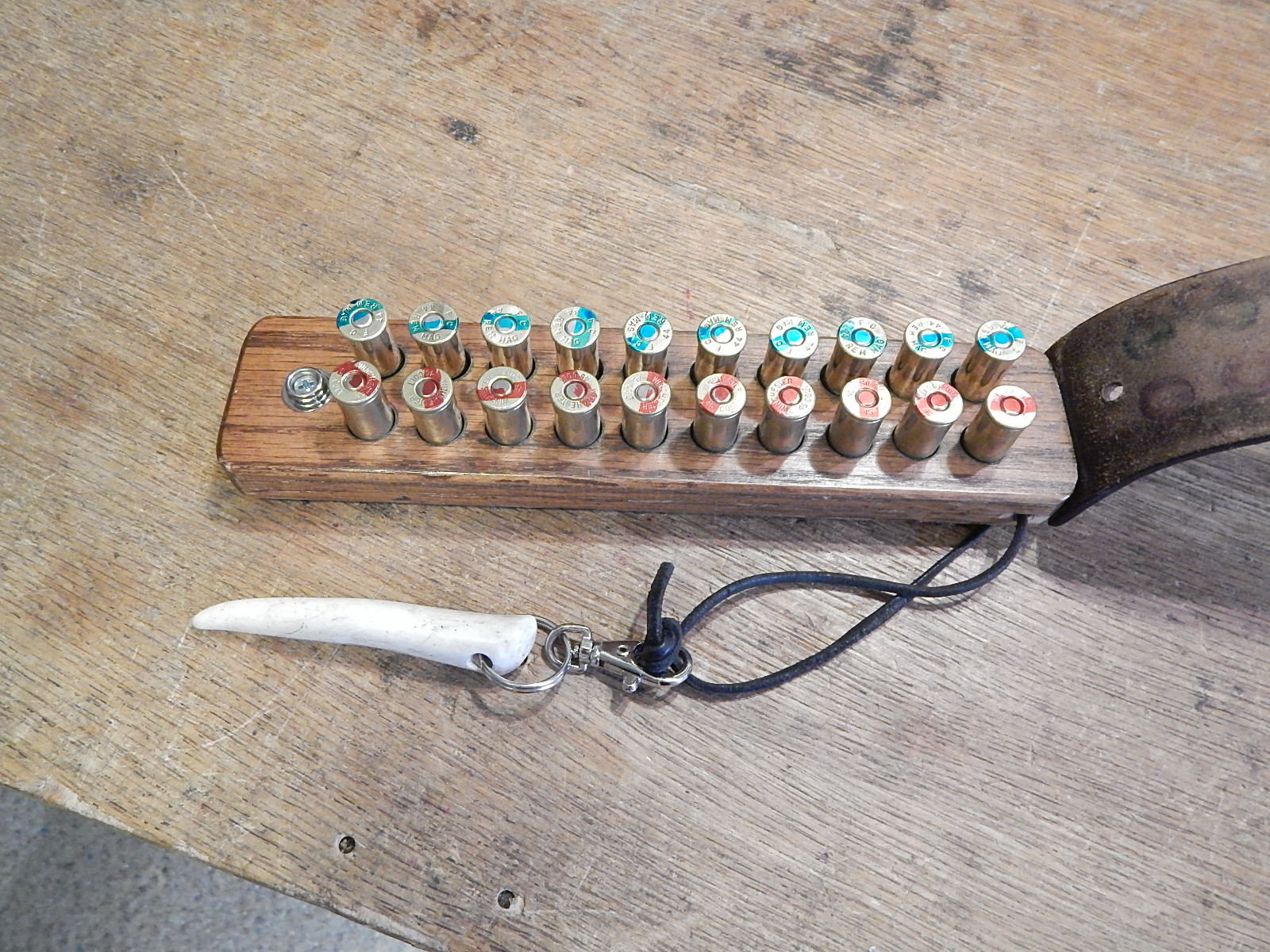

I've been shooting Cowboy Action matches since 1997, I own firearms in multiple calibers that I can mix and match with. Currently I'm using a pair of .44 Mag Ruger "Original" Vaqueros and a Uberti M73 Carbine in .45LC. When I bring my firearms to the loading table I also bring a wooden loading block containing 10 rds of .44 & 10 rds of .45LC. The bases of the .45LC cartridges have a wide red stripe made by a marker pen across the base. I've been shooting this combination for close to 8 years now and never had a problem mixing calibers up. The advantages of using a loading block made of either wood or leather can eliminate any number of stupid mistake plus you won't be considered one of those extremely inconsiderate individuals that clutter out the loading table with ammunition boxes.
Garand nailed it. Every mixed caliber cowboy shooter I know, marks their cases in such a way that they are instantly recognizable at the loading table. The alternative of course, separate each caliber cartridge by way of dedicated loading blocks/strips, etc. Stay organized...and a person can't go wrong.

Only an idiot could screw this up at the loading table! Blue is .44 mag, red is .45 Colt

I like your loading block Garand, I have been making a few of them here for me, my daughter (hers is 22), and a couple shooters just like that except with a space to break the rounds up into groups of 5. Working on a holster belt in between the bathroom reno work.
