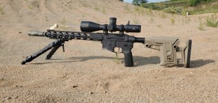

I built an MRA Renegade, 20" Faxon match barrel.
Hand loaded - 32.5gr CFE 223 with 62gr ELD-VT, Federal GMM205 -AR primer - runs 3630fps
Very nice 😊 Scope is a 🤷‍♂️
What brass ? You using ?
The scope is an Arken EP-5 5-25X56
Just using Hornady brass for now. I need to figure out some issues before going to better brass. These crazy MRA renegades have issues with hard extractions & I'm still fighting with it. Even with wimpy 300BLK I had hard extractions.
But those 3600fps loads werent the best loads & on the high side for pressure. Once work & hunting season is over I'll get back into it.
