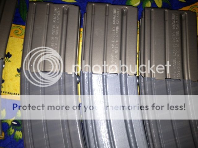

All you mags should be tested for additional clearance when loaded with 5 rounds. By pushing down on the top round, you should have enough compression to almost load another round. This makes it easier to latch the mag when loading under a closed bolt. I call this clearance a 5.7 round mag. I have had a number of mags that I can barely get the last round into and they have no additional movement. I call these 5 round, or 5.1 round mags.
The fix is easy peasy. Just file a bit off the bottom of the follower, where it hits the rivet, to allow the column to depress a bit further. Just a tenth of an inch would make a big difference.
There is not enough room to drill a new hole for a rivet. It would be too close to the old hole. So remove the rivet, take the mag apart, file some off the bottom of the follower and install a new rivet in the old hole.
