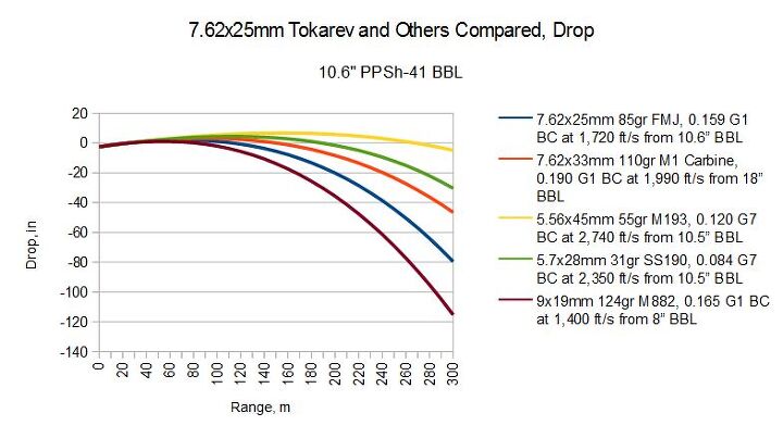

But that makes me wonder, Is 7.62x25 even worth the bother these days? It doesn't seem to be all that much cheaper than 9mm these days, and its all surplus corrosive ammo
As I understand you can't have it sighted and cleaned at the same time. Not to mention short pistol barrel and R status. This old German 7.63x25 Mauser round, copied by Soviets, deserves proper carbine size firearm.NP762 Kidon carbine conversion...

It is not just about the price and about ballistic trajectory, which is quite similar, though slightly better with 7.62. It's more about having a smaller calibre round that is more potent and more penetrative. Think as in level 3a vs high speed 7.62x25 from carbine. It's just a beast. Though as I had mentioned before I would go JR carbine conversion way in Canada or AR conversion in USA, definitely not SKS conversion way.
