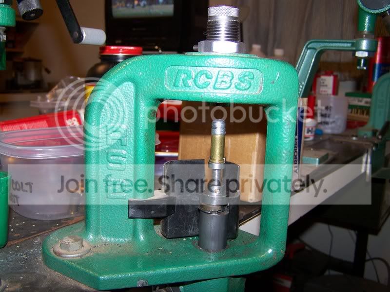

I reload for several obsolete heeled calibers and I had the same problem at one time. When I ordered a mould for my 11mm French Revolver from ht ttp:www.oldwestbulletmoulds.com I also ordered his crimp tool for the same. Bernie is a great guy and makes very nice moulds btw. What came was a Lee crimp tool in 45cal with a modified adjustable base. Once I got it set up it made great crimps. Since then I have purchased other Lee crimp tools for other calibers and used the same adjustable base or made up something different. A picture of Bernies base is here: (Not my picture)
