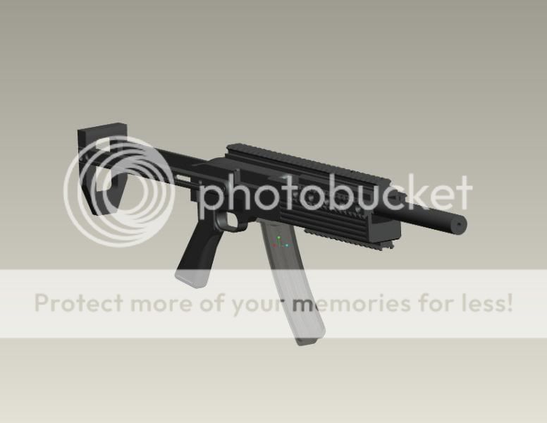

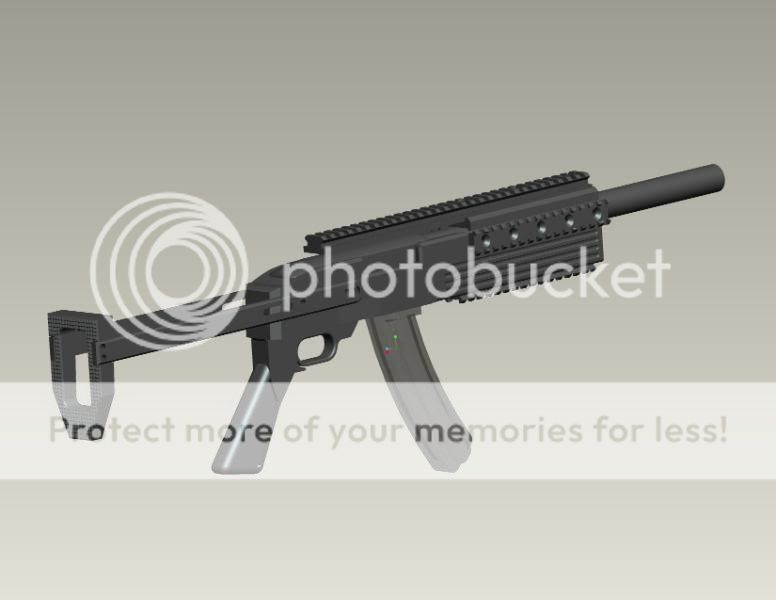

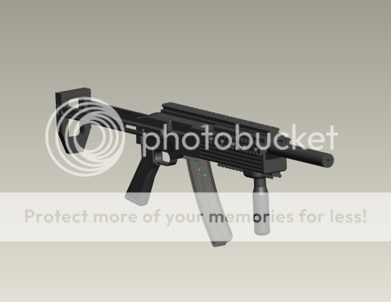

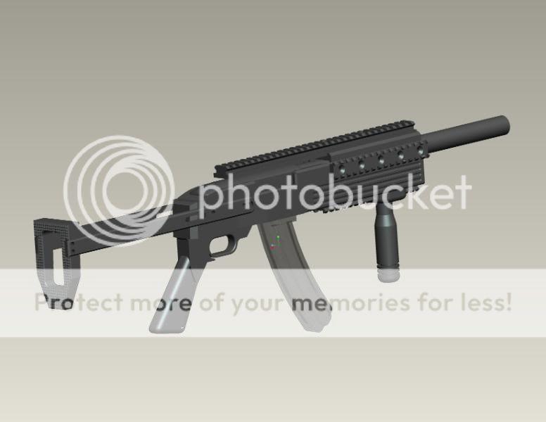

I'm thinking of bringing my company into the arms game and I'd like to know CGN's opinion of our first stock for the Ruger 10/22.
Below you will find some screen caps of the stock in its solid model form, and as the title states, it's going into prototype this week. If there is interest, I can update the thread as it progresses.
I know some people dislike this style of stock, but feel free to comment or critique any aspect you can think of from form to functionality. Please keep it constructive.
Specs:
BSC MK4 10/22:
- CNC Machined body and components from 6061-T6 AL with the utmost in rigidity and accuracy.
- Flat black anodized finish. (more color options may become available depending on interest).
- All rails shown are included with the kit. (VFG not included).
-Stock length (minus ar buttstock) 16.6"
-Stock Width: 1.75"
-Upper rail: 15"
-Bottom rail Lenght: 7"
-Minimum barrel length for non-restricted: 11" (with ar buttstock collapsed, 7.75" typ.)
-AR grips, AR buttstock
-Assembly/Dissasembly to retrive 10/22 action/barrel, 6 hex cap screws (all the same size)
-Top quality customer service
-5-15 Business day delivery
-Estimated retail price $295
-And most importantly: CANADIAN MADE :cheers:
Please note: these screencaps lack some finishing touches (such as mounting hardware). Also note the stock appears to be thicker than it actually is. Dimensionally, the forend is 1.75" wide.
BSC MK4 10/22
Mininum length configuration
11" Heavy Barrel
Factory 18.5" barrel
We also have an M14 stock in the works under the same design philosophy...
Thank you for looking! We appreciate any feedback you may have!

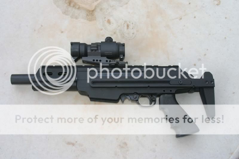

i have the rhineland arms with the slider stock and i like it but you need an 18" barrel with it when its all the way in to meet the 26" criteria. Mine is a skinnier piece by looking at your image. Just like a mp5. How long is the front part of the stock? Hehe Is there any way to make it look more like an mp5?
Good to see more stocks for the 10/22.
It looks a whole lot like a EVO stock who slept with a Rhineland Arms stock...
Haha, yes it does. Thats because I love the look of both of these, and they're made using mfg processes we have.

In your picture i'm not sure i like the shape/placement of the grip. I looks too far back.... can you make a pic with the grip and trigger forward alittle bit?
Also I personally dis-like the boxy-ness of the fore-end, it just looks like a brick to me. My suggestion would be elimnate the 6 o'clock rail and round off fore-end similar to the rhineland one.

i'd do a mockup wiht the 25 rd mags to get a better look at the template.
EDIT: added pics to the OP.

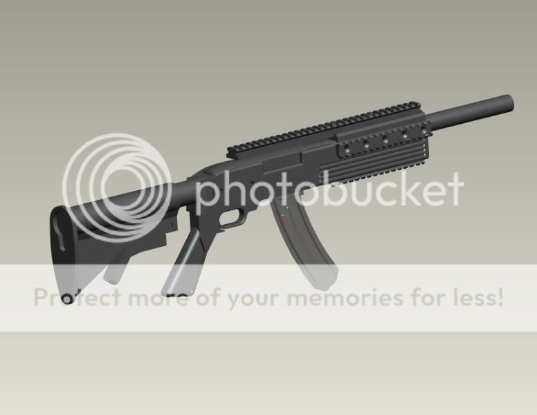

Here's a ROUGH mockup with an AR stock.
