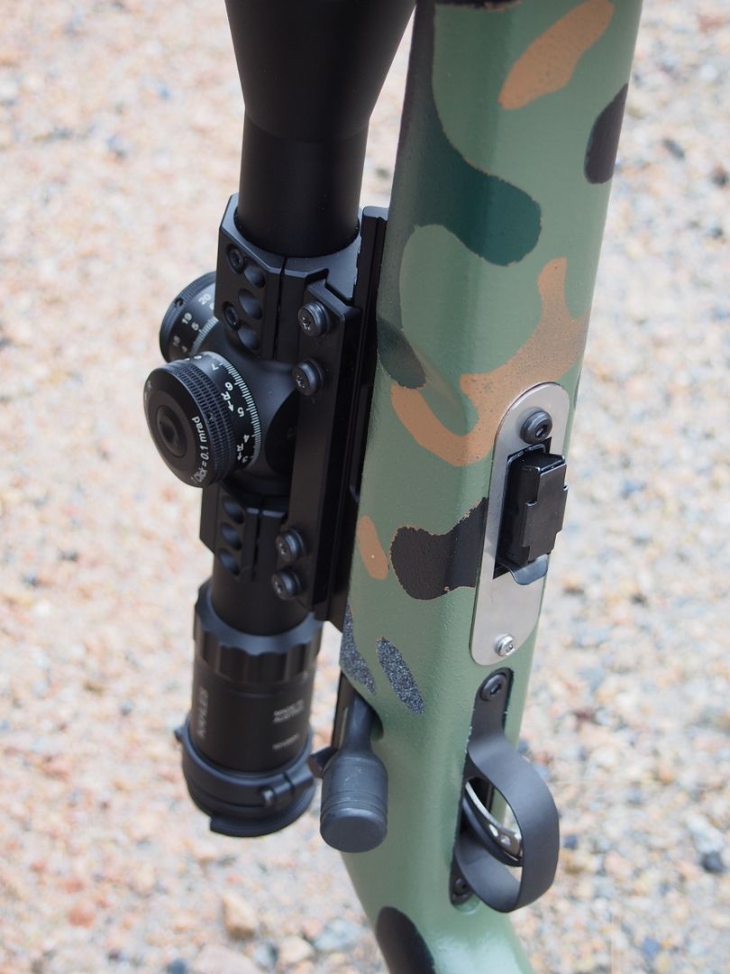

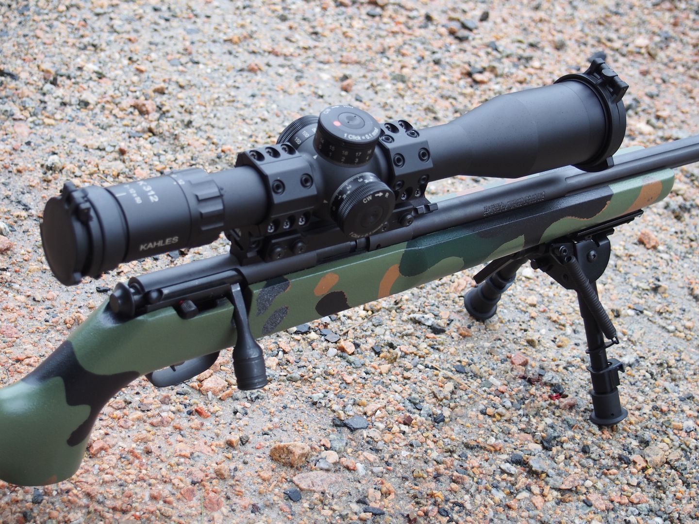

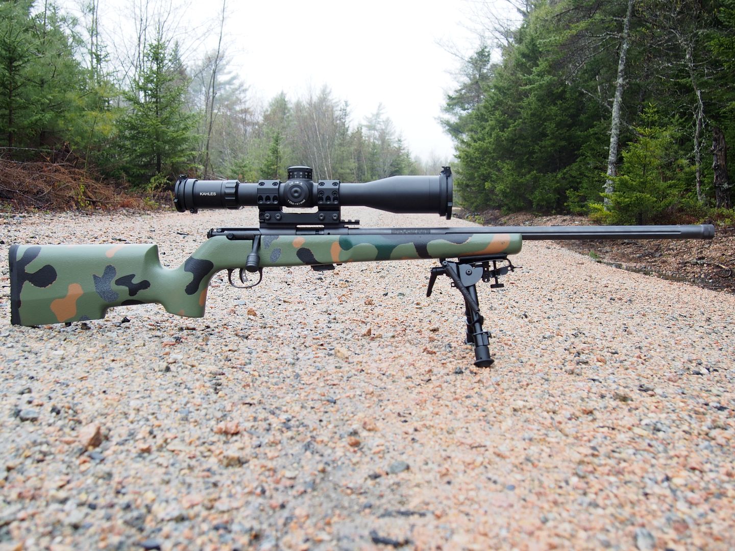

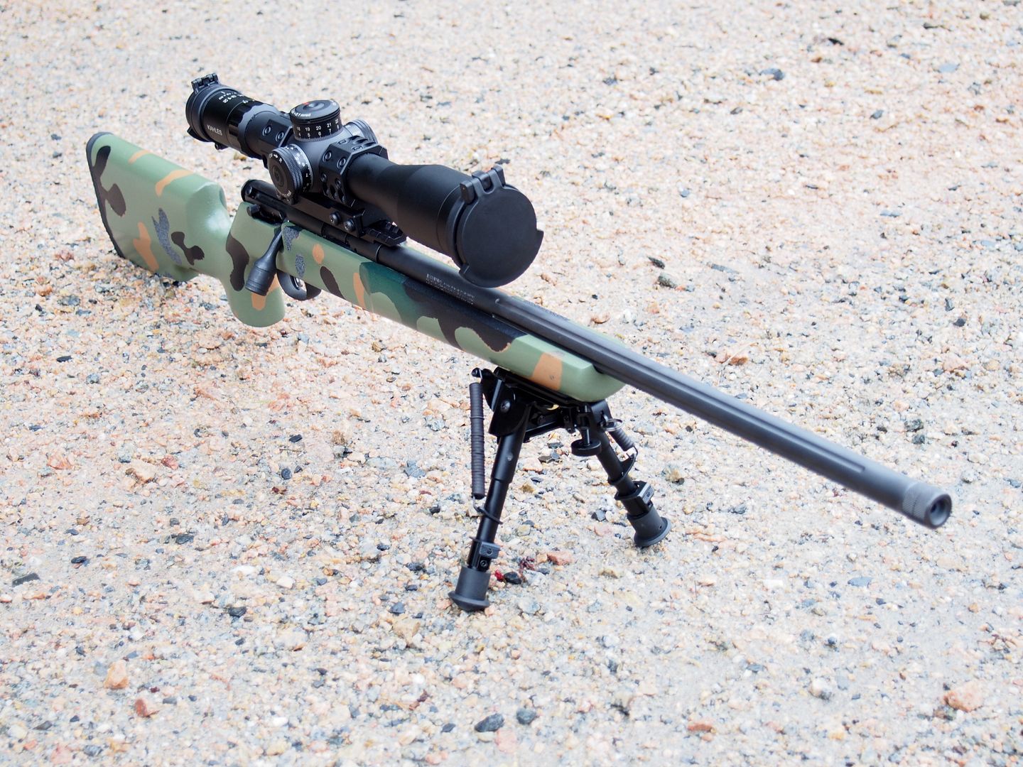

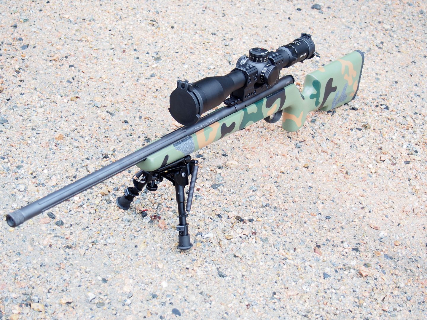

The rifle is a Savage MKII TRR-SR, with the factory boyds stock. I did a little custom paint job on the stock and sanded the barrel channel some more to make sure it was free floated under pressure.
It has a EGW 20 MOA base, with a SPUHR 4002 Mount, and a Kahles k312ii.
I get impacts out to 300 consistently as long as I do my part and read the wind! great shooter, Punches one ragged hole with Eley and SK match, all seem accurate. Settled on CCI Standard Velocity as it is cheap and still offers accuracy that is more then acceptable!

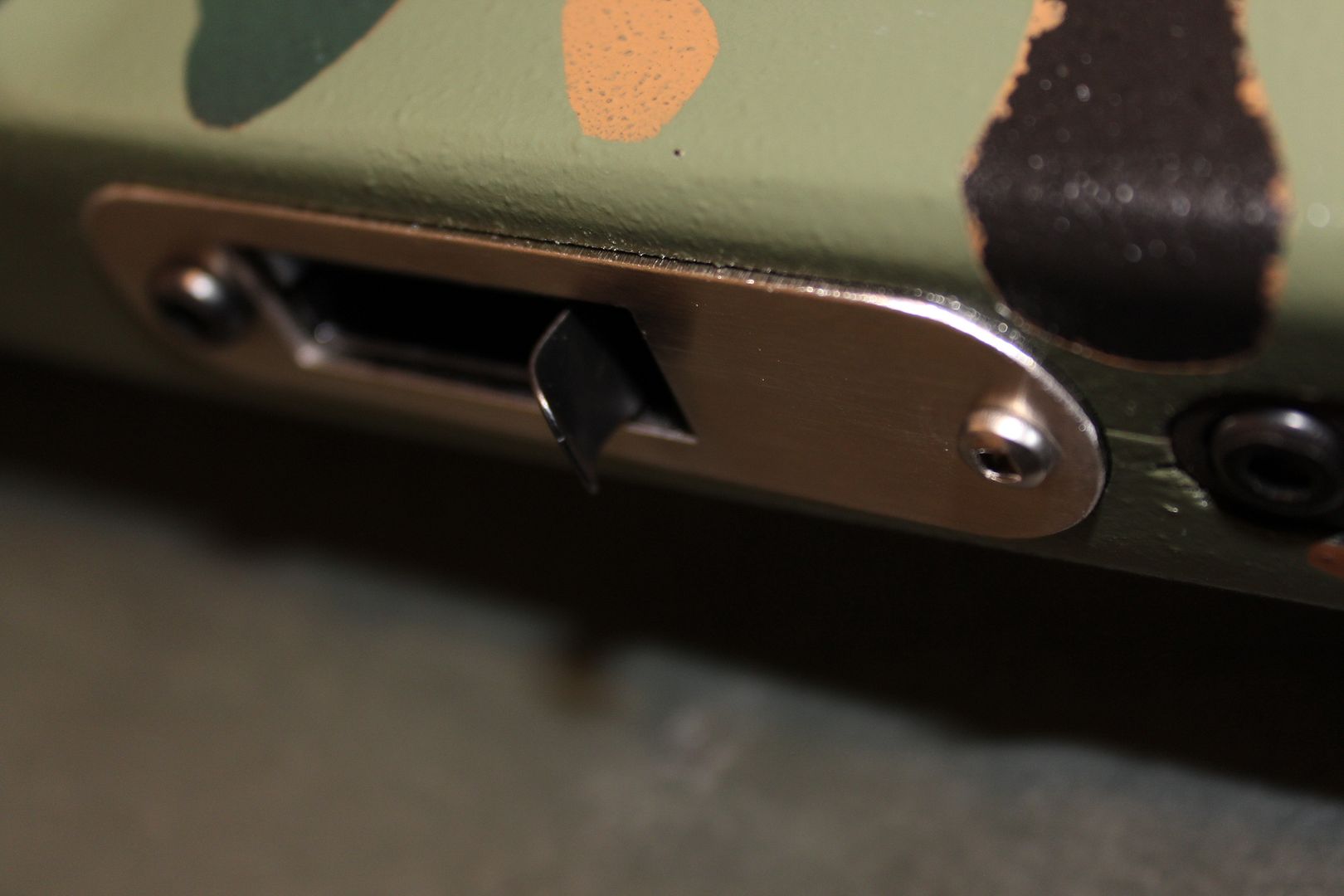

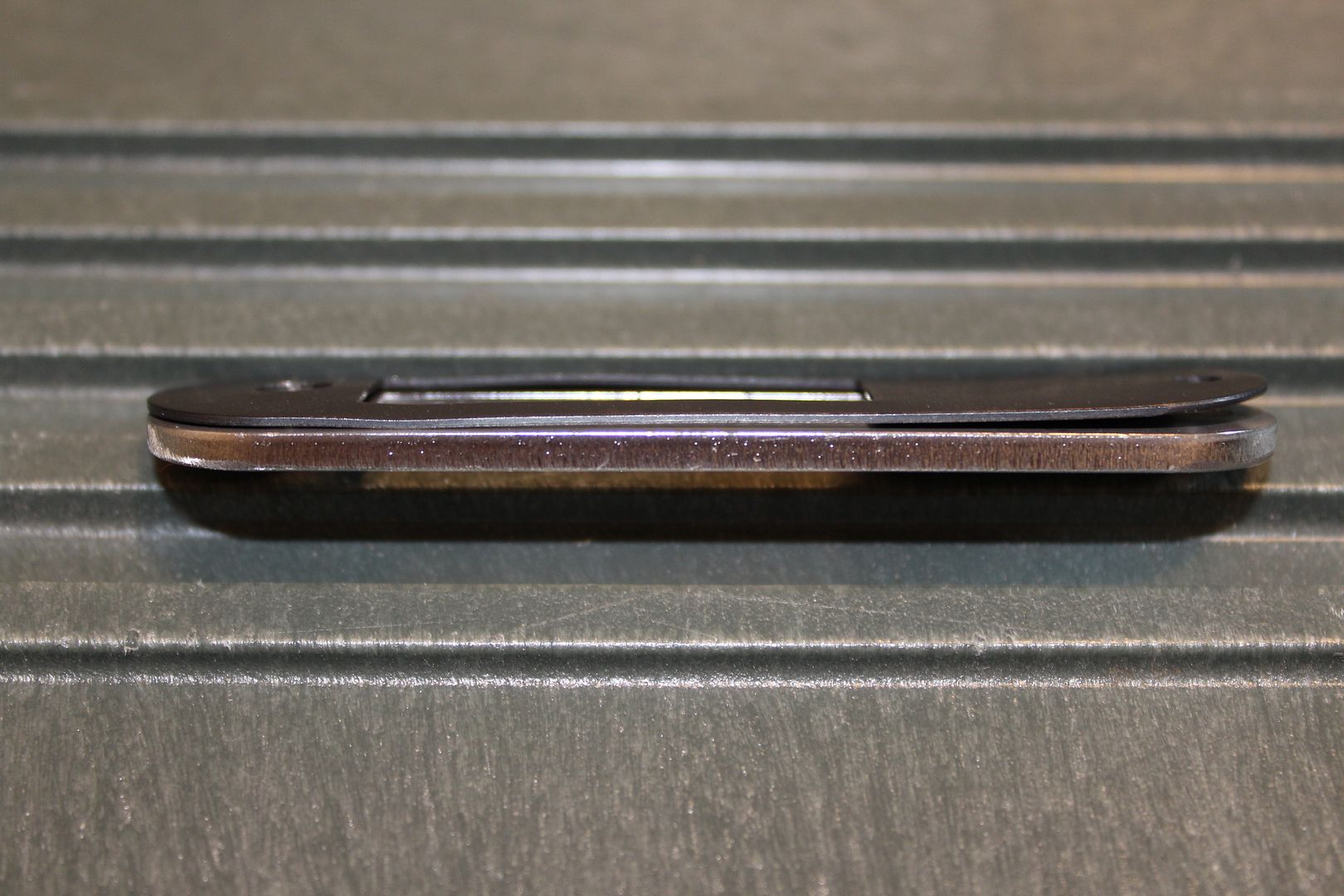

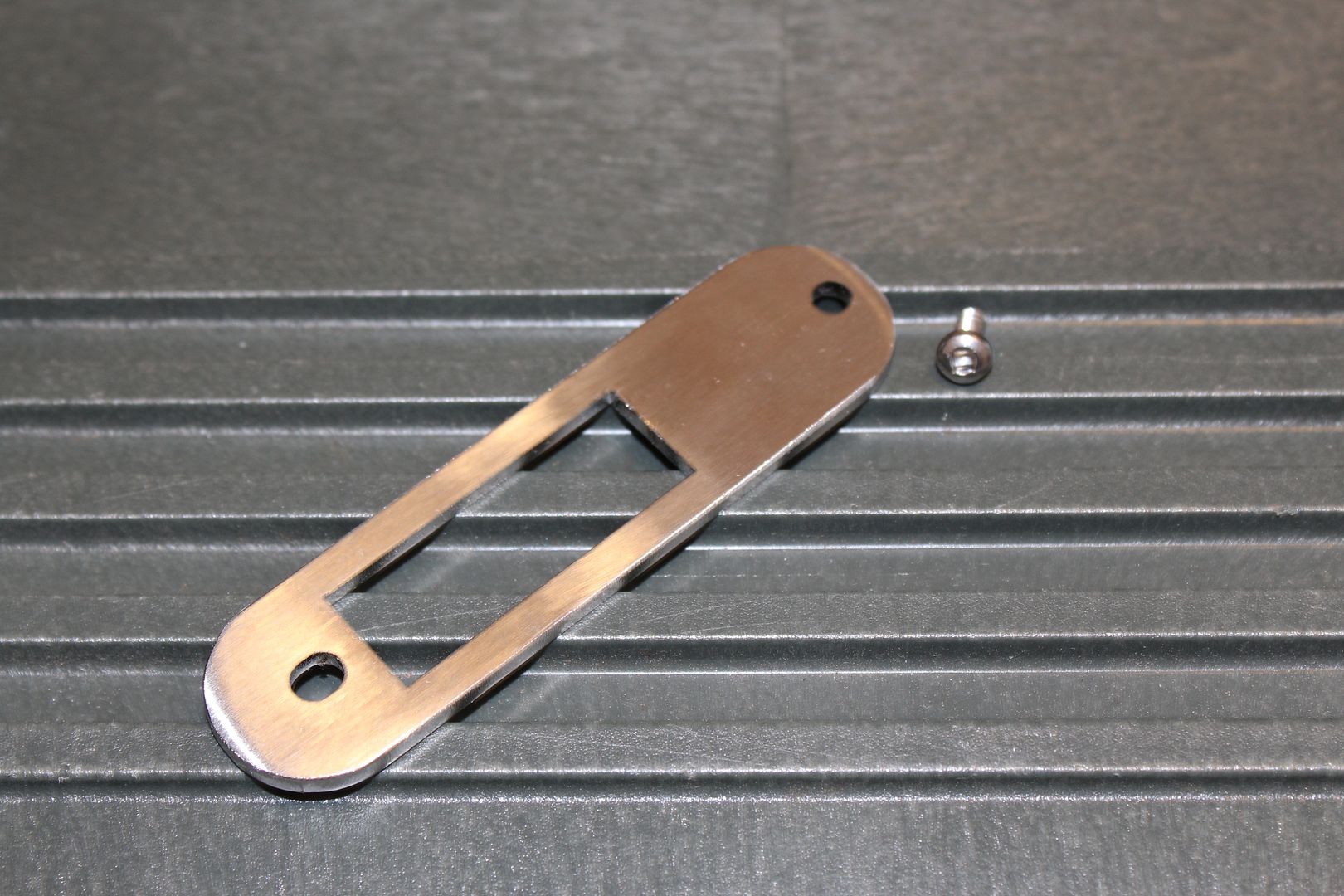

The issue everyone has is those flimsy Bottom Metals! I laser cut a 1/8th piece of stainless steel and paired it with a a Stainless Steel #6 1/2inch Robertson pan head screw to replace the existing screw. I can now torque the action screw without any issues. I have attached a picture with the old bottom metal on top of the new one to show the difference.
If anyone is interested in these please let me know, I might considering making some for others. They would be for the newer MkII / BTVSS and I believe they would only fit the wood stock (they would probably fit other stocks with some minor sanding, unless the older MkII's had different screw placement, as I used my OEM bottom metal for the measurements PM me if interested!!!.

I need that bottom plate! Lol
