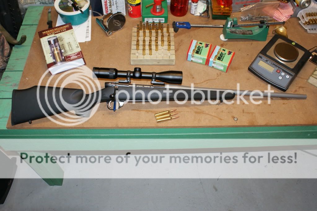

Hi everyone, I would like to share my custom .25-06 that is finally together.
The rifle consists of a 22 1/2" #3 sporter contour SS McGowan barrel that was chambered, threaded, fit and cut by Dennis Sorensen. The muzzle is cut with an eleven degree target crown and the finish is bead blasted to a matte finish. It sits in a McMillan Edge stock that was inletted, glass bedded and floated by Dennis as well. I used a Weatherby Vanguard action that is fitted with a Timney trigger set at a crisp 3 pounds. The scope is a Swarovski Z3 3-10x42mm with the plex reticle. It sits in 1" standard Leupold rings and bases.
I would like to thank all who helped in making this possible.
Dennis Sorensen for amazing gunsmith work and fast service.
Jerry at Mystic Precision for providing the McGowan barrel and excellent support/service.
Omer at plainSight Solutions for giving me a great deal and service on the scope.
I cannot wait to load up some of Marshal Ambrose's (AKA Matrix Ballistics) 125gr flat base bullets to see what this rifle is capable of.
I hope you guys like it as much as I do. It sits at a scoped weight of 8lbs 6ozs.
