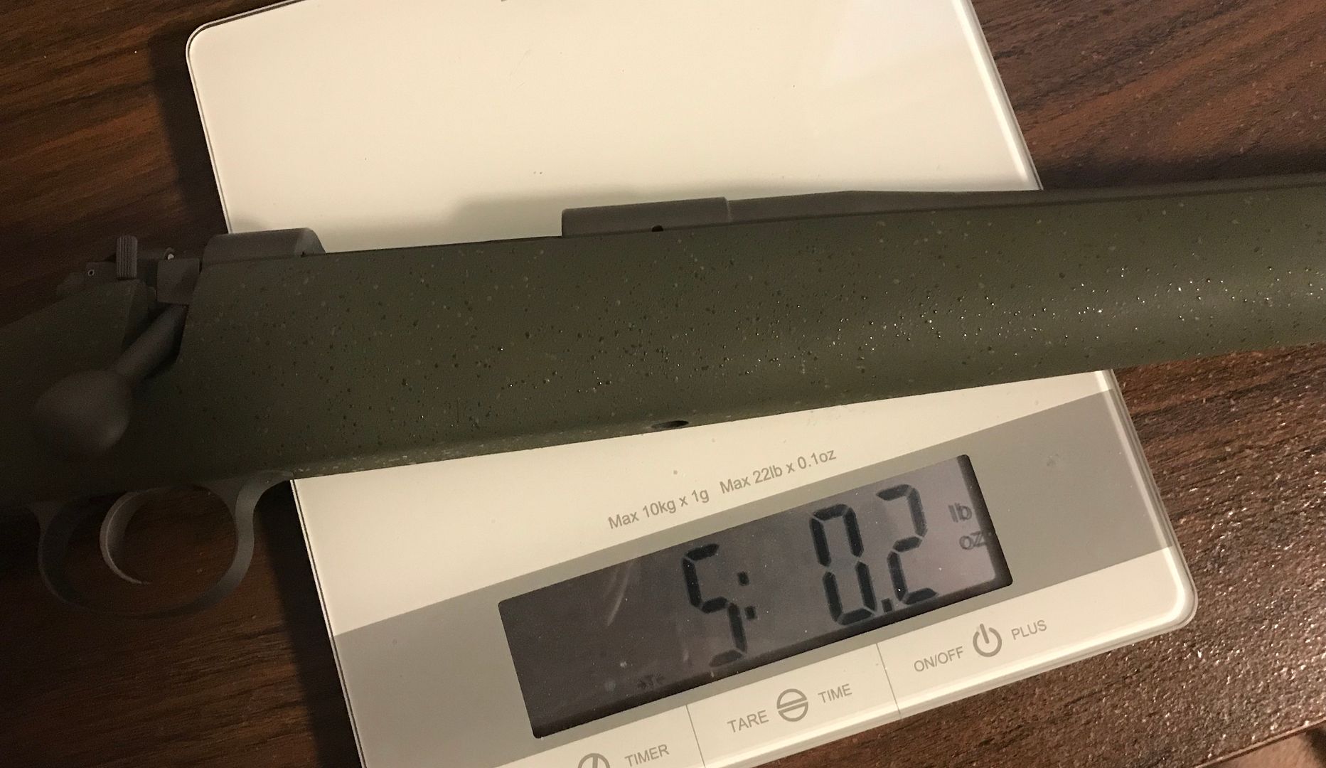

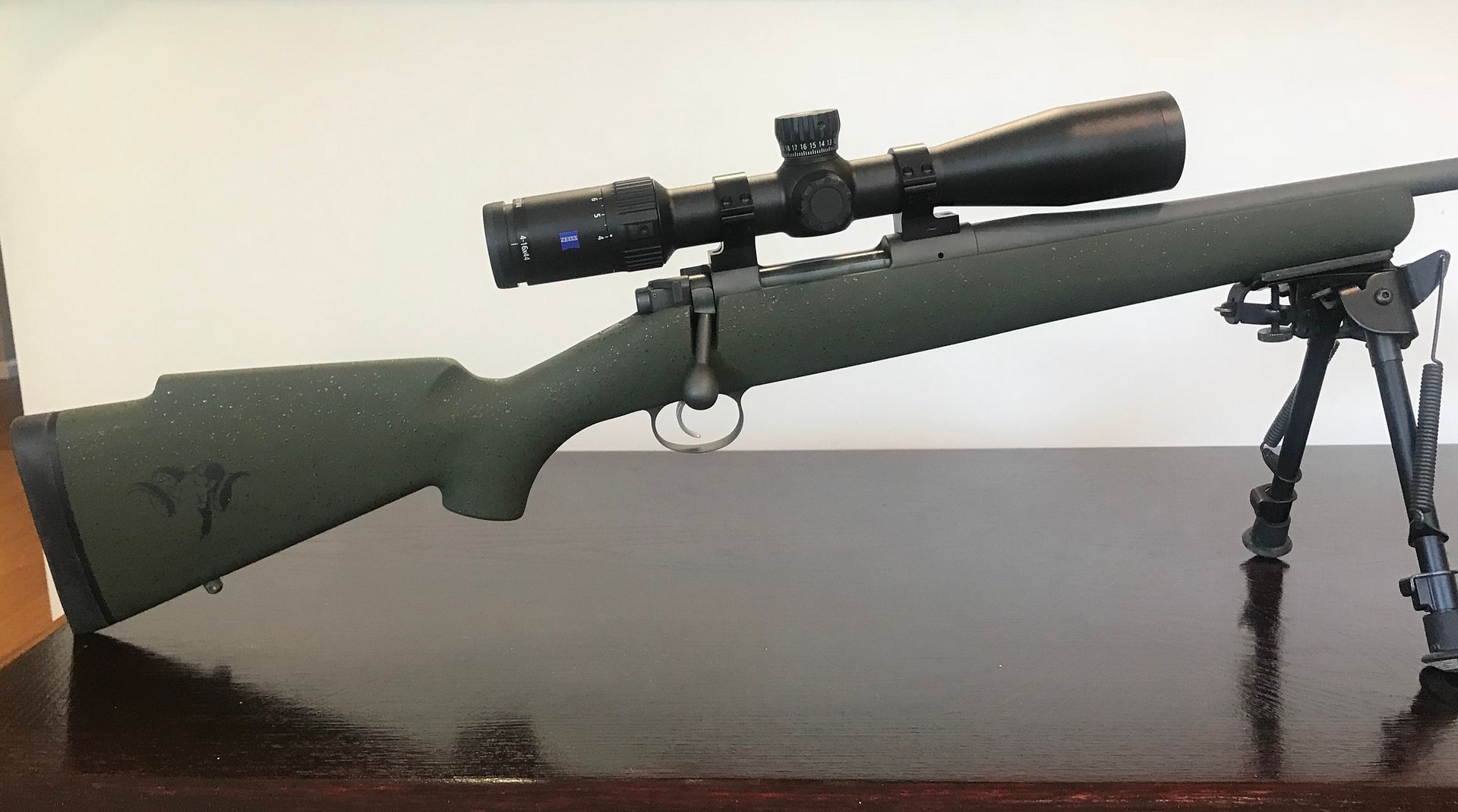

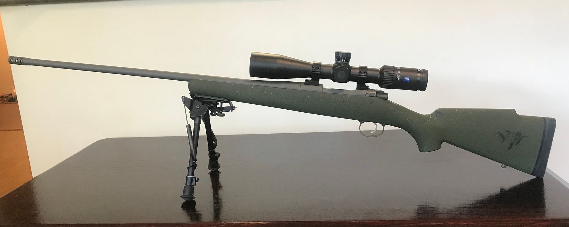

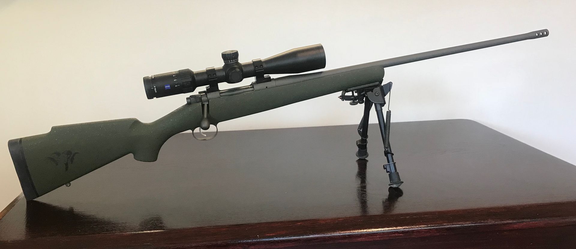

I was wanting a lightweight sheep hunting rifle and thought 6.5 Creedmoor but gunsmith Gary Flach says nope lets do a 6.5-284 Norma on a Kimber Montana 84M action, Ill open up the mag box for factory ammo as thats what I normally shoot, so here we are and so far Im extremely happy with the outcome and as usual Garys workmanship was first class.
Kimber Montana 84M Action Trued, Squared & Slabbed and an alloy bolt knob, lightweight trigger guard
Factory trigger set at 2.5 lbs
22" SS Benchmark 1-8 twist, 5R, #1 contour barrel, custom built muzzle brake, holes angled forward on 3 sides but not on the bottom, barrel 24" with brake
Talley Lightweight Rings
Zeiss V4 4-16x44 scope will put a lightweight scope on at a later date.

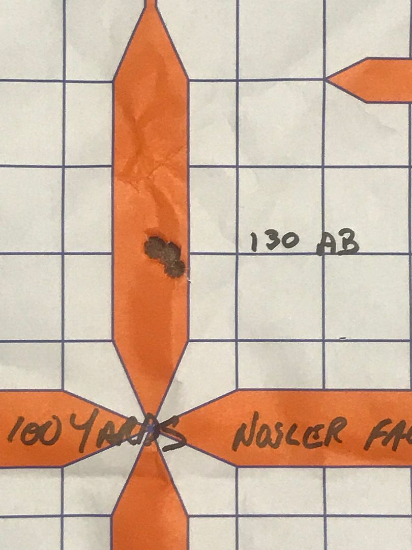

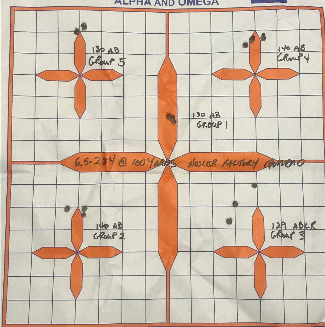

First trip to the range and the rifle is a dream to shoot with that brake on there, I was trying out 3 Factory Nosler loads, 130gr AB, 140gr AB and 129gr ABLR
I started with the 130gr @ 2800 fps, two to zero the rifle, a good cleaning and the first 3 shot group did not disappoint, no fouling shot required by this rifle !
Group 2 was with the 140gr Accubonds @ 2700 fps, group 3 was with the 129gr ABLR @ 2820 fps and nope it certainly doesn't like those bullets
Group 4 was with the 140gr AB again and was so so, and the 5th group I went back to the 130gr AB and pumped 3 shots out as fast as I could.
Cant complain about those Benchmark #1 barrels they sure do shoot.
