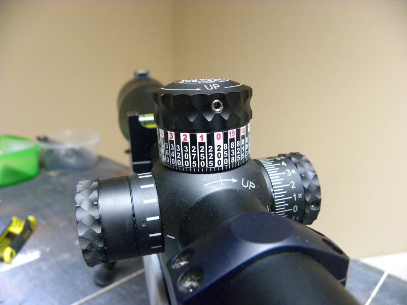

After a lot of thinking I decided to do a printed tape that I would stick directly on my turret, I would do my ballistics by the .5 MOA for more accuracy. I have done the design with a drawing program and printed the tape on label for VHS cassette. After alot of trial and error to fit the lines of the tape with the lines of the turret the concept worked realy good, no more loosing time reading ballistic charts, it was much faster (coyote hunters know wath I mean) and also this way no risk of loosing or forgeting your charts. After some time 2 things still bug me, the resolution was not great, in low light condition the numbers were hard to read and the tape realy did not like the rain, I tried to put some Scotch tape over it for protection but if I would shoot in heavy rain the numbers would just fade out.
Old model on Nightforce scope standard turret, the numbers on the bottom are the ballistics of the first rotation, the one on top are the ones of the second rotation, the red numbers are the MOA

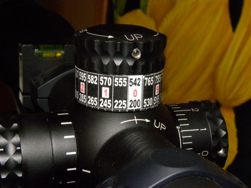

The solution: I just bought a 4 colors process printer (I work in advertising) and tried to make my tape with this printer, the result were phenomenal, the resolution is alot better, even at dusk when I cant see my target in the scope, I can still read the numbers on the turret and rain is'nt a problem anymore, the tape is made with the same materials used on car graphics[
New tape on Nightforce scope with "High Rev" turret. You read numbers from top to bottom, red numbers are the MOA
Ballistic info on top of the turret
After alot of work, I think my project is finaly a success
