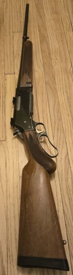

Hello fellow gunnutz,
I picked up this BLR at an auction. Description of rifle was a bit off to say the least. I paid way too much for what this rifle is. Would of been a good deal if it was in decent shape. What's done is done. I accept my purchase.
7mm-08 Browning BLR Lightning.
I want to completely restore/upgrade/ modify this thing. I want to say that %100 of the work will be done myself. I didn't mention this soon enough in my other thread, that most people told me to scrap the project because it would cost more than buying a new one.
I wanted a BLR because it seemed to be the perfect rifle to track whitetails, bear and wolves with.
I made a previous post about this rifle titled "Browning BLR in ROUGH shape",
https://www.canadiangunnutz.com/forum/threads/browning-blr-in-rough-shape.2560715/
And I was mostly looking for opinions on what to do with the barrel. It has a bore that is beyond what I call acceptable for rust. Pitting the entire length, and the chamber is so pitted you can see it on fired casings. The only rifle I've seen worse, is an SKS that spent years shooting corrosive ammo.
Anyways, I've mostly made up my mind what to do with it now, so I figured I should start a build thread. Eventually I may swap the barrel out to a .338 Federal, or .358 Winchester, but for now, she's going to be 7mm-08 Ackley Improved.

I've already removed the barrel. I have a new take-off remington 700 7-08 barrel that I will modify to fit, and re-chamber.
