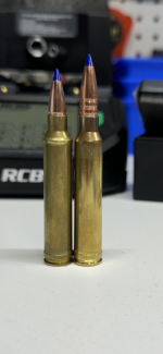

I built very similar to what you’re looking at last winter. I went with a throated out 300 win mag rather than PRC as I hand load and had new Lapua brass already. I had KS Arms chamber, thread the barrel and make a thread protector and install a Trigger Tech trigger. I dropped it in a HNT 26 chassis and have been very happy.
KS Arms 3 lug Lightweight Action
Bartlein 26” Carbon fibre barrel 1:9 twist
Trigger Tech Special Trigger
HNT26 non folding with ARCA
Leupold backcountry low rings
Leupold VX6HD 3-18
Weighs 8lbs 4 oz scoped
Shoots 180gr Barnes TTSX @ 3235fps with H1000 sub MOA
SAAMI vs my throated out length for reference
KS Arms did a great job and at the time at least the turn around was quite quick
Leupold VX6HD 3-18
