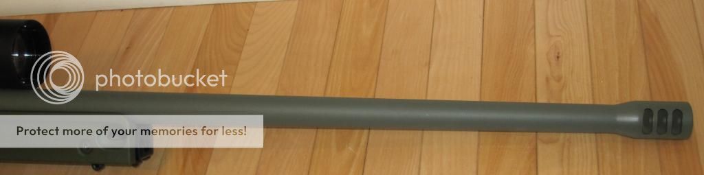

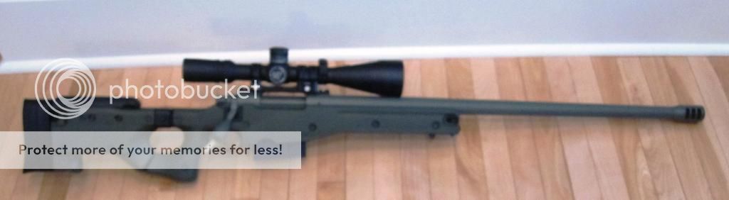

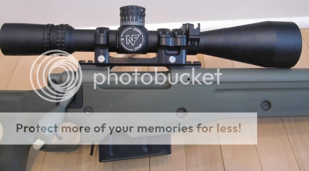

The second rifle I have nick-named the Green Monster. It's a Rem 700 SPS trued action mated to a match chambered 300 WM, Broughton 26" 1-10" twist barrel with a 3 port muzzle brake and the same .250" recoil lug. The gun was also sent to Arma-Coat for an Olive green coating, then I added a NEAR 25 MOA rail and 30 MOA Alphamount which secures the 5.5-22x56mm NP-R1 Nightforce scope and Flatline Ops Bubble Level. Dropped this gun into a 2.0 AI chassis and will be adding a sinclair tactical bi-pod.

Love the near alpha mount, Flatline ops level and the bipod looks great too.

That mount + rail on the 300WM is AWESOME!!(if it zeros at 100y). Having the full 100moa to play with should get you out to 2 km.
