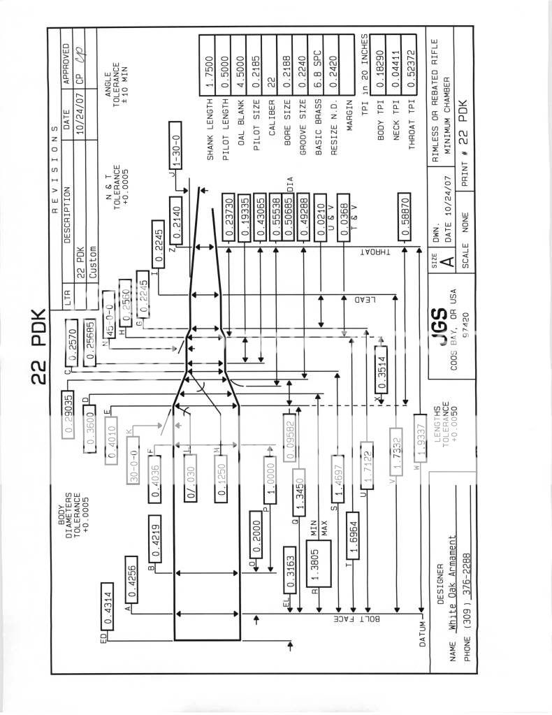

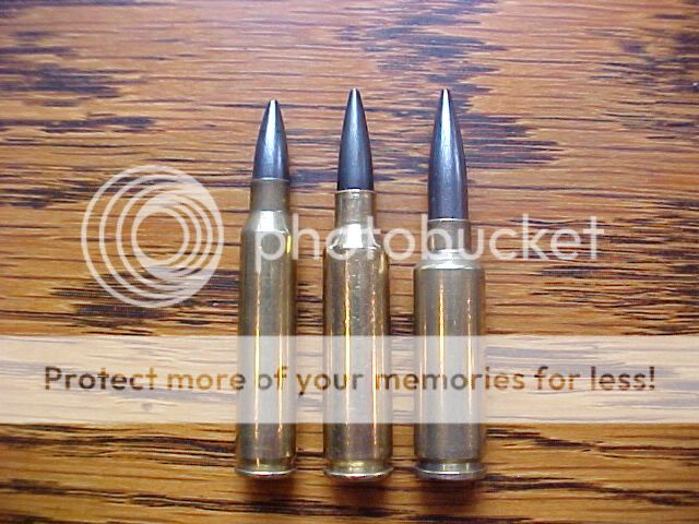

Here is the round I would like to see and I'm drooling just thinking about it...
Oh yeah one upper in 22PDK for gophers/predators & the other in 6.8 SPC spec 11 1-11" twist for predators/deer/bear...
Something tells me that the velocities are a bit high in the data but he was using a 24" Lilja barrel for the tests I would want a 21" - 22" thin contour (not as thin fluted would be even better) s/s match grade barrel...
22PDK (22-6.8 SPC
(6.8 SPC is the parent case)..
Beside a 223 on its left & some wildcat called 22 Rat on its right...
