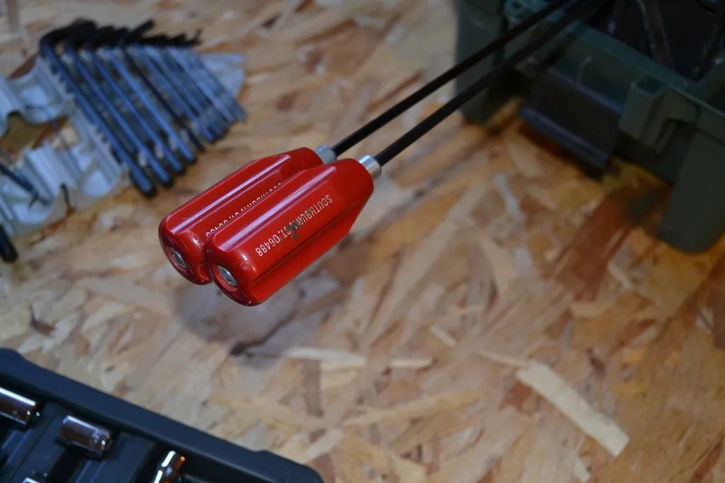

Is there an easy way to remove and salvage/reuse the handle on a Dewey cleaning rod. I want to shorten the length of the rod to fit a hard case. Handle looks like this...

The issue is probably going to be getting the front ferrule off the fibreglass rod. Have you contacted Dewey? They might have a sectional rod that meets your needs. (You're probably not the first person to ask.)
He sells replacement handles, so I would think the handle should come off someway, the back end of the rod cut and then the handle reinserted
just a thought
I was hoping someone had tried removing a Dewey handle before and would share any gained knowledge! I hate being first to try something as I usually frick it up. :) I could just brute force the handle off...
It is easy to take the handle off but the bearing race is built into the rod body. So the short answer is no. Now if you want to re-engineer the whole thing .. Dennis has it simple!! Or buy a shorter Rod.

If you actually remove the handle be aware that the bearing balls are not captured inside and will spill all over the place both top and bottom bearings.. Don't ask how I know this..��

I have. :) Took the handle off, making sure to save all the ball bearings, easy to lose. Cut the rod and then rethreaded it. Size escapes me right now, but a standard size. Where I had to trim the rubber coating back for threading, I installed a piece of electrical heat shrink insulation. Handle back on, not too tight, Presto. Rod is hard, so a little tough to thread, but can be done.
