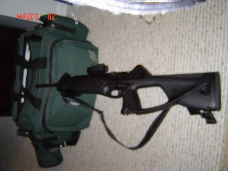

Here you go. Sorry for the picture quality.
NaOH well it isn't very good but certainly good enough. Eventually I plan to install a metal trigger group which helps things along quite a bit. When shooting fast between targets at 50 yards you hardly notice how heavy it is. As a gun designed for defensive shooting it certainly is capable out to 100 yards. For what I bought it for it will do nicely. Very inexpensive to shoot which is a major bonus.
