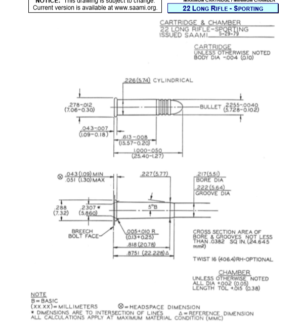

A Sporting .22 LR chamber is .8751 in length from the bottom of the rim to the top of the throat compared to .6876 for the Match chamber. The length of the Sporting chamber from the top of the rim to the start of throat is .818 compared to .643.
The Sporting chamber at the base of the cartridge is .2307 wide compared to .2267 for the Match chamber. At the throat the dimension of the Sporting chamber is .227 versus .2248 for the Match chamber.

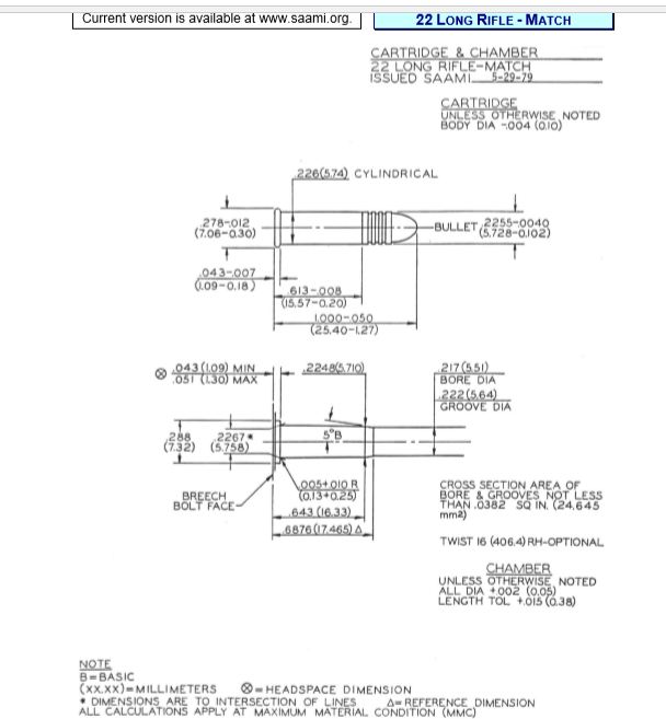

SAAMI and CIP set the specs for ammo and chambers. SAAMI generally applies to North American factory rifles. There is a SAAMI Sporting chamber and a SAAMI Match chamber. CIP, which includes most European firearms makers, has one set of specs that establishes the minimum/maximum dimensions allowed.
Note that every CZ .22LR will follow CIP specs. The chamber dimensions shown below for CIP are the minimum allowed. The CZ match chamber will be closer to the minimum dimensions permitted by CIP while other CZ bolt action rifles will have longer chambers.

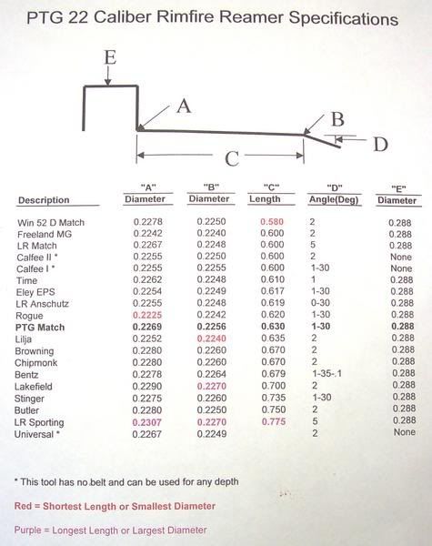

There are a number of Match chambers that are made for custom barrels, and some of them are shown in the last image.
CIP 22 Long Rifle, below.
Below, SAAMI Sporting chamber and Match chamber specs.
The reamer dimensions for some custom Match chambers as well as others.
