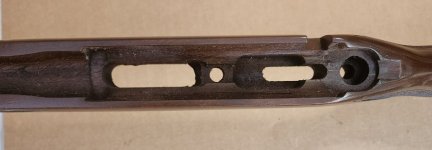

No problem, I've been browsing everything CZ rimfire in Canada the last few weeks, that's why I knew about it. If it was a few years ago Frontier was selling beautiful 452 stocks for very cheap, I think like $60, I bought two and modified them for norincos, one 22mag and one 22lr, unfortunately the 22mag was stolen a few days after I modded the stock for it. here's what they looked like.

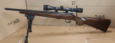

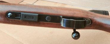

The 452 Varmint stock I got was a direct drop in fit onto a 452 American.
Perhaps the model is not 452. The CZ 452 American has two action screws, one under the rear tang, the other ahead of the trigger. The CZ 452 Varmint has a single action screw and a barrel lug. The stocks are not interchangeable.
Barrel channel differences aside, CZ 455 stocks are interchangeable as are CZ 457 stocks.
The stock was advertised as a cz452 Varmint .....my reciever says 452 American.
It was a drop in fit.
Zero modifications.

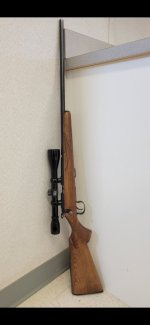

Original stock below
Drop in fit, no sanding filing, filling or shaping
Knowing CZ, even if one stock only uses a single screw, the action itself will still have both tapped and in place. They haven't changed the footprint in like 50 years since it's inception as a BRNO
