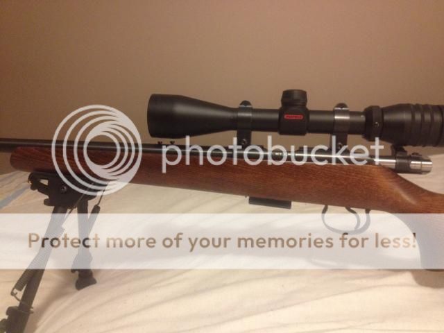

Love my 455 Lux. Originally purchased as a .22LR Supermatch, barrel was swapped out to a .17hmr, and a yodave trigger kit was installed. Topped it with a Redfield 3-9x40 on some Talley CZ rings, and put a Harris 13" bipod under it. It's a blast popping gophers at 150+yards with this thing.

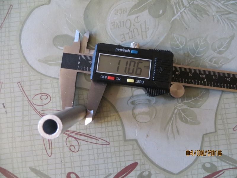

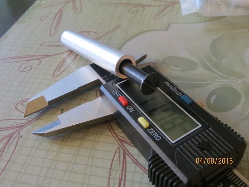

Perhaps the link has changed. I linked the item Amazon says I previously purchased. In any case the spacers have quite enough room for the action screws. I bought two packages and have enough stock for several lifetimes of material to make pillars. I made two pillars out of one tube and there were 20 tubes in a package. Kody and Ronnie01, PM me if you would like me to send you some.

This is the "varmint" or a standard stock for most rifles here in NA....
I may not be an expert, but I know how to fit a firearm...We all have different shaped heads, also find different positioning of our head comfortable (this is why the ruger precision can cant/tilt its cheek comb back and fourth as well as move up, down, forward and back). The stock was not at an adequate high for proper cheek positioning for myself. It would have been fine for irons. It was about an inch and a bit too low for my optic... Doesn't help the bolt throw is so damn high thus making me use high rings, also fueling my doubtfulness that they are to "lend" themselves to scoped rifles...

Action screw inside the pillar (unmodified stock tube)
Yup, that makes more sense; its more like 7 mm i.d.+/- and not 5.5 as advertized on the Amazon link.
