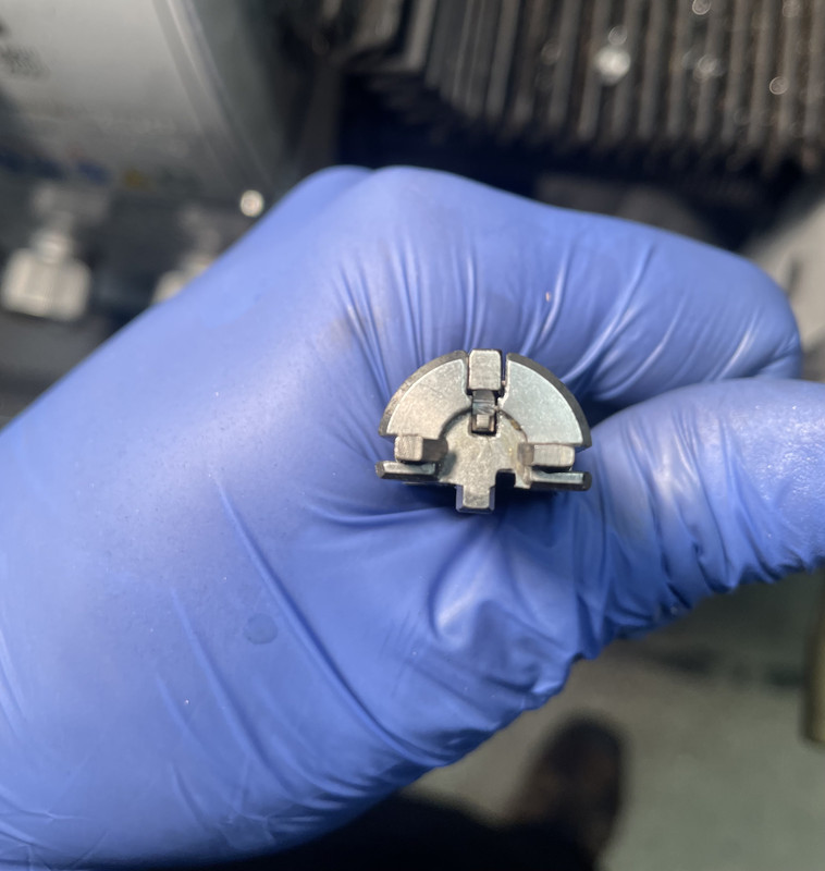

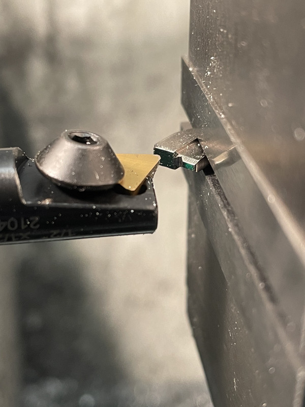

While I had my milling setup installed for the last project I was working on, I took advantage of it to do this mod before I changed back to a standard lathe setup. There are a number of ways to do this job, even using a file and some patience. I selected a single flute end mill and the part angled at 45 degrees.
There's some play in the firing pin channel vertically, so I had to see how it actually rides and hits the rim. I cut to a safe depth then started to test fire, taking small cuts each time until the correct dimension was achieved.

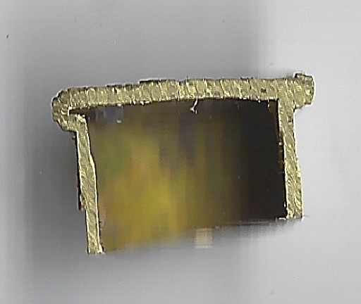

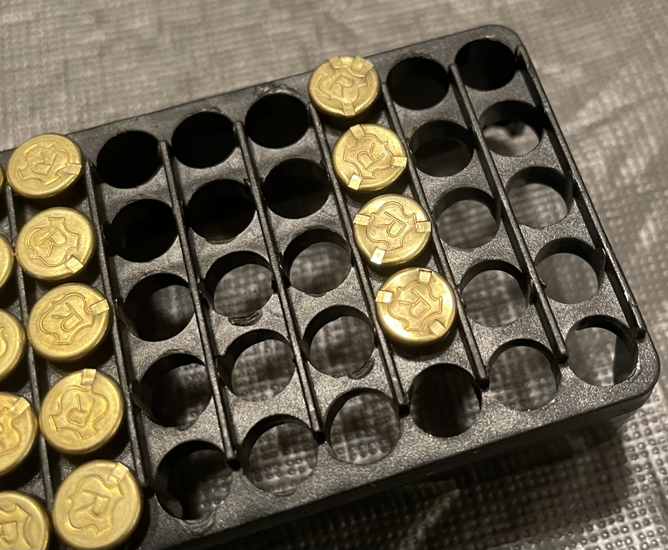

The casing in the 4th row is the only one showing when I had done enough cutting. I split a casing open to examine the hit in detail. This looks good, the rim is closed up fully, no evidence of deformation that might occur with too strong or deep of a strike, and the edge of the hit looks like it clears the folded case wall section. Nice.
