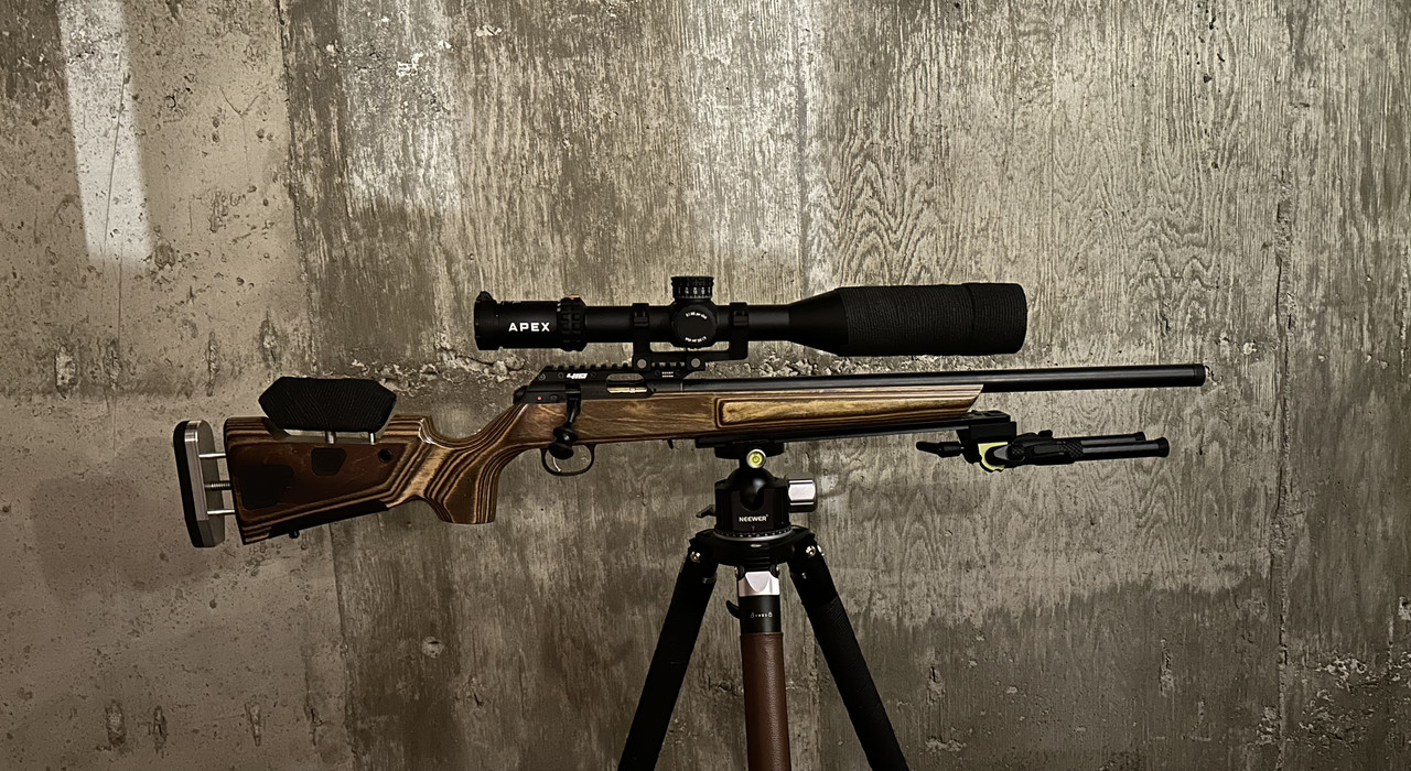

Yes, same accuracy. Mine has the match chamber and the factory CZ457 At One stock is a special version of Boyd’s. I didn’t like the style of the MTR stock, and I wanted something I could play with for rimfire PRS. When I bought this, the MDT XRS version was available, but I don’t like the FDE colour. If they had black available back then, I’d have gone with MDT.
I found scope mounting with a big scope to require a bit of fiddling. I bought the Apex scope for PRS, and used a one piece mount so I could move it to my centerfire PRS rifles. It’s a touch tall for my liking, but built up the cheek riser to fit. The Area 419 scope rail is a bit short, and so you can see where I put the mount to make the eye relief work.
Nice thing about a solid wood stock is it’s easy to flatten the stock to bolt up an Arca rail. It was a cheapie from Amazon.

- it has action pillars in it! The generic Boyd doesn’t.
- this variant has more wood compared to the generic Boyd (grip area and bottom of the front stock). It feels nice in my hands.
- the adjustability is another plus for sharing with others. Adjustability is very limited though. I own two MDT ACCs and the thumb wheels are missed here, as is the lack of range.
It is accurate though. I’ve successfully done the 50m 1/2” challenge with it.
Stock specific things:

I’m using a Nightforce with 20moa built in. My Area 419 rail has 30moa. With this combo, and the Apex zeroed at 50m, I have 25.7 mils of elevation left to dial. Plenty.
I like the 1-piece mount so I can move this around from rifle to rifle easily, until I get more cash to dedicate a scope to this rifle.
