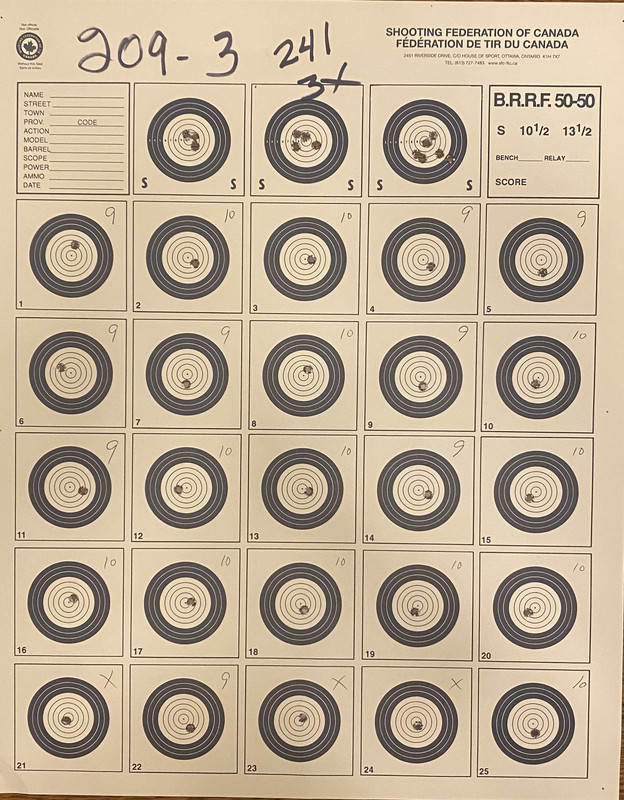

I purchased a brand new 16” 457 MTR 2 weeks ago today.
A CGN'er reached out to me about a local rimfire match.
I decided to attend.
There were 2 categories under 10.5lbs and over 10.5lbs.
My MTR with scope and Harris bipod attached weighed in at 9lbs 15.5oz.
The only modifications to the rifle were a YoDave trigger spring and an Area 419 bolt knob.
There were 3 of us shooting in the under 10.5lb class. The rest were in the 10.5+ class.
As far as I could tell all the rifles in the 10.5+ class were Anschutz with the exception of 2 (#802 and #901 were RimX).
Wind was gusting between 10-15mph.
With less than 500 rounds through the rifle and limited ammo testing I think I did pretty well.
Targets were shot with Lapua Center-X.
The right hand sighter on target #4 was shot with SK Rifle Match after I finished my match as I was waiting for others to finish.
3 rounds through 1 hole.
I need to do more testing with SK Rifle Match.
My takeaway from this match was that I need a lot more patience since I never took more than 10 minutes out of 30 to finish my targets.
