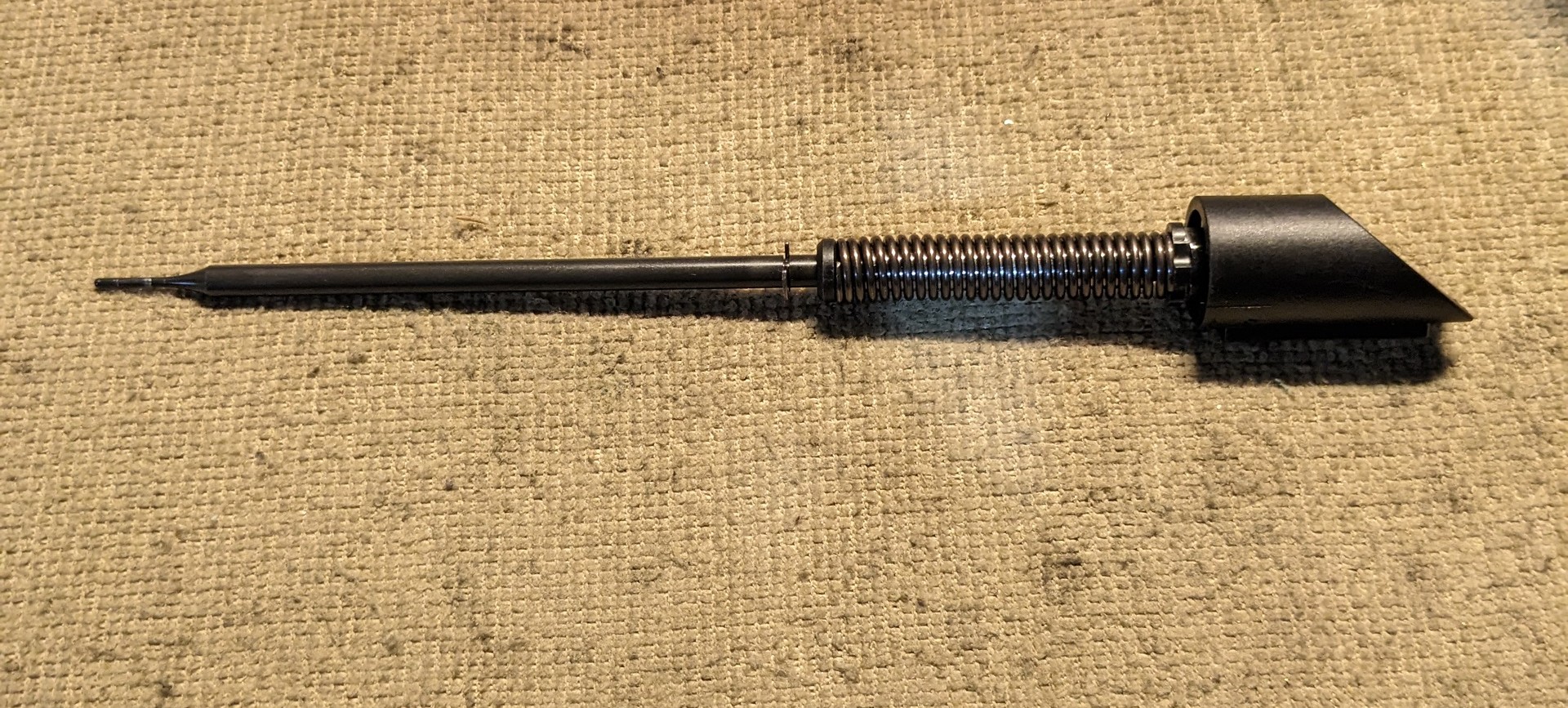

Wow, a picture is worth a thousand words! The firing pin/spring assembly on a Howa mini is Huge in comparison. I wonder how the 600 in 7.62 x39 does with surplus primers?

Well, from looking at the firing pin assembly, it doesn't look easy to take apart at home.
From what I recall when I had mine, the cocking piece doubles as the firing pin stop, there is no "adjustment" anywhere on the assembly, so yeah, I'd be curious to the fix as well.

The zkk 601,600,602 and respective 550 “copy” guns are the only ones I’m aware of that have fine threads and a screw on collar, on the firing pin that retains the spring.
The pic you posted that’s one stubby spring. What’s the function of that “c” cir-clip just forward of the collar on the pin?
Anybody measure pin fall distance with the bolt in and out of the rifle?
