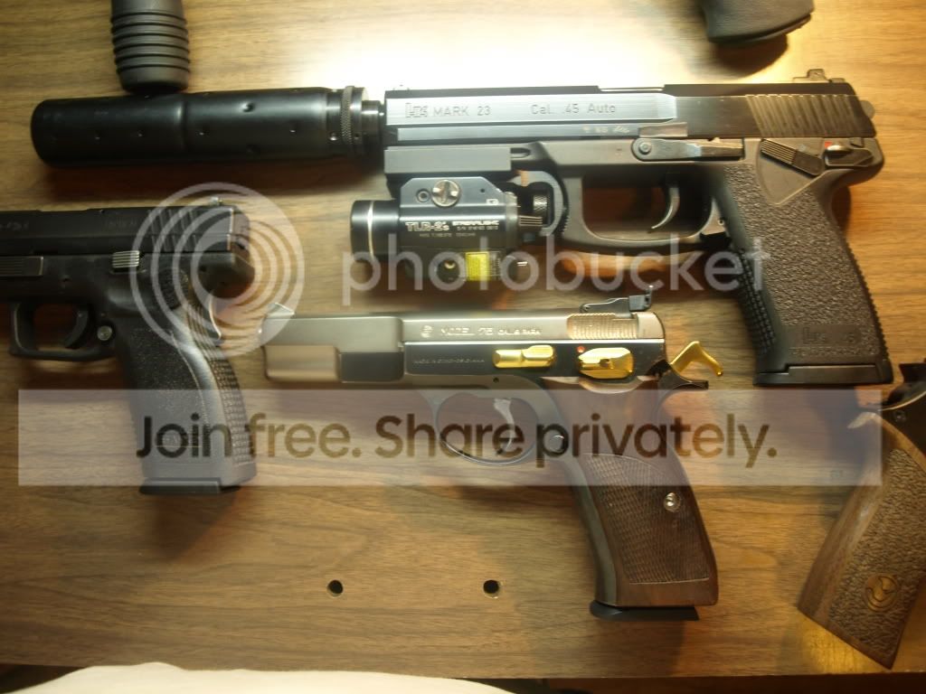

I picked up this CZ-75 a while back.
I dont own a CZ-75b but maybe this pic might help out ?
The original mag was preventing the action to stay open after the last round. I picked up a brand new CZ mag (intended for 75b, Shadow etc) at Target Sports and it now works perfect on this older CZ-75.)
It required no bending or fiddling -- Mind you the mag rattles when it has 10 rounds in it, hence Ive only purchased one --- still looking for one that wont rattle when its loaded.
