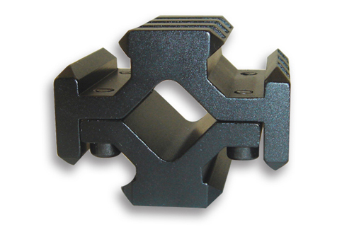

I finally got around to modifying my UTG barrel mount.
The UTG mount was bought from Marstar (actually I had to buy two for an extra bracket); why no one makes a mount specifically for this purpose I'll never know.
Anyway, I'm happy... I finally got my irons visible through my RDS :)
EnjoY!
http://www.marstar.ca/ac-optics/mounts-semi.shtm
LP-MNT-BR002
As I said I bought two... I removed the main portion of the mount completely (I didn't like how bulky it was) and had to take the second top bracket from the second kit (these are what clamp the barrel).
I then went to my local hardware store and bought some longer screws (x4) and nuts (x16) to act as spacers as well as to clamp the barrel; two in the middle (I needed a 6mm lift in order to get a good co-witness with the FastFire) and two nuts on the bottom for extra strength.
*Note: One can make the mount with just one kit (instead of small bracket on bottom you use the large double rail bracket).
