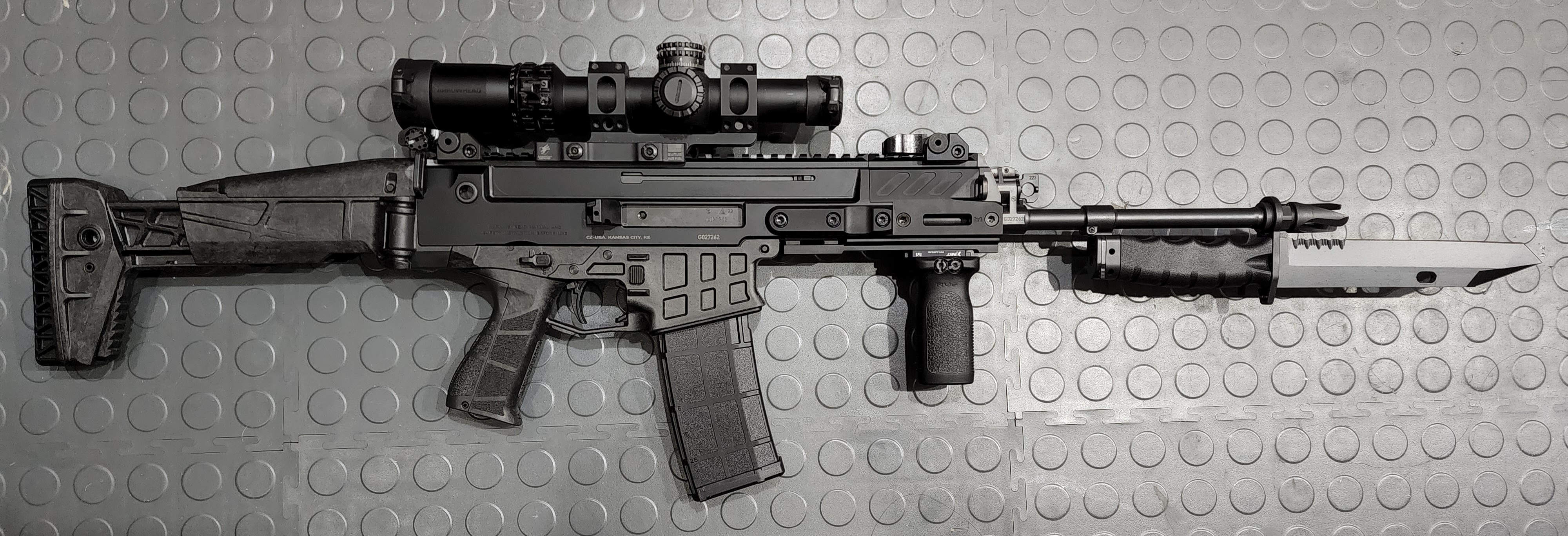

Well, it has finally arrived - "on loan" from our State Masters until they ban it, most likely this Fall. At least I will have this summer of my weekly range trips to both enjoy and analyze the attributes of this new (to me) platform before the gub'mint wreaks further havok upon law-abiding firearms owners later this year as promised by the Turd. In any case, enough of that crap in the fullness of time. For now, it is happy, happy new gun day in my world!! And what a gun it is - the long-awaited, just issued to Ukrainian Forces, CZ Bren 2 14" "Rifle" (as designated in current Czech Repubic service). The first thing that struck me upon hefting the new rifle is it's comparative light weight for a 14"-barrelled, short-stroke piston system. You expect to lift the weight of an ACR, B+T APC223 or HK 416/MR223, and instead you get something about 2/3 the "conventional" weight of such a rifle. This is largely attributable to 2 aspects of theBren 2 - the first being the pencil-weight barrrel and the second being its carbon-fibre reinforced polymer Lower Receiver and Buttstock. The Pencil Barrel does not concern me in terms of its longevity/durability under conditions of sustained fire, as it is cold-hammer forged and properly stress-relieved by the CZ factory. The Lower Receiver and Buttstock are not significant stress/pressure-bearing parts of the rifle, and as such they are perfectly fine being constructed of ultra-lightweight synthetic material. It is thick, rigid, and appears to be very durable. The Trigger pull is outstanding for a service rifle and is well-suited to target shooting as well as more practical applications. The ambi controls fall readily to hand and the integral Bolt Actuation Device (Bolt Catch and Release) is an excellent design, akin to that found on the Bushmaster ACR but placed within the Trigger Guard more akin to the HK G36.
My 14" Barrel came equipped with the Bayonet Lug, and as such is configured exactly like the standard Czech Republic and Ukrainian (soon to be) Service Rifle. I could not be happier with what IRG delivered, and would therefore recommend them for all of your remaining restricted firearms needs! Accessories include a SwampFox 1-10x LPVO in an American Defense Cantilever Mount, and a Magpul Vertical Foregrip attached to a Kinetic Development Group QD MLOK Rail. The Magazine and Back-up Iron Sights are standard issue, included with the rifle.
Based on what I can ascertain thus far, even without firing it I can state without reservation or hesitation that (subject to a cofirmatory test-fire), I would happily carry a CZ Bren 2 Rifle into harm's way. It is a very solid short-stroke service rifle design with many of the attributes that professional users have been requesting for years. I will readily go out on a limb and state without hesitation that the Bren 2 is at least the equal of the Colt M4, and is actually superior in a number of ways (eg. fouled reliability, fully ambi controls, folding Buttstock). Pretty impressive for a relatively new design, but if anyone could do it CZ certainly have the background and capability. The Bren 2 is a perfect (albeit pricey) replacement for the AR15 in Canadian civilian hands, and is therefore amost certain to become prohibited in the Fall of 2022. In the meantime however, SUCK ON THIS POLY!!!

So I took the Bren 2 MS with 14" Barrel out to Annual Range Day at the CHAS Range in Geneessee. AB. What a treat - it was all good news, from reliability to handling and everything in between! Reliability was 100% using a variety of STANAG magazines, including PMags. The rifle is perfectly gassed, cosnsistently ejecting empty casings into a neat pile at the shooter's 4 o"clock. The Trigger is an excellent 2-stage affair, with a crisp let-off and minimal overtravel, but a fairly long resent that is both tactile and audible. Perceived recoil is no more than that of a properly gassed, 18.5" DI AR15 without the sharp impulse normally associated with piston systems.
Accuracy was more or less as expected of a Cold Hammer-Forged, Stress-Relieved, pencil-contour Barrel. Groups with Winchester White Box 55gr .223 ammmo averaged 2 MOA or slightly less, with group sizes quickly openning up to 3 MOA as the barrel heated up after the first string. Five-round, cold-bore groupings with 69gr Federal Gold Medal Match averaged 1.5 MOA at 100m.
Handling was excellent all around, thanks in large part to the Bren 2's overal light weight and the placement of its ambidextrous controls where they fall naturally to hand. The redundant Bolt Catches and Releases function with finger pressure using llive ammo. The rifle's neutral balance makes it lively in the hands, easy to manoeuvre and quick to get on target. The Bren 2 is a comfortable rifle to carry and use, thanks in large part to its surprising light weight (even when accessorized) and its non-reciprocating Charging Handle.
With all of its positive attributes considered, and noting no negative characteristics whatsoever, the CZ Bren 2 MS is without question the best Modern Sporting Rifle to hit Canadian dealer shelves since the original AR15. Sadly, this almost ensures its forthcoming prohibition in Canada when round 2 of the May 1st OIC catches up with new market additions in the Fall of 2022. More's the pity, as the Bren 2 is a perfect (albeit expensive) replacement for the previously prohibited AR15. Welcome to Kanada, 2022. Not a good year to be a Canadian firearms owner....
