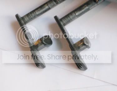

CZ now sells modified slidestops, so, it'll be within factory specs and should not throw you out of Production.
Pic of the mod:
Pic of new modded factory slidestop:
I'd still recommend filing the original since the new one is shorter, you'd need to reach further with your thumb to release slide, compared to regular SP-01 guns'.
