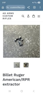

I also bought a new Gen2 Ruger in x39. The extractor is a MIM part (metal injection molded) and it broke within the first 5rds with steel case ammo. Others have had the same happen. Not sure if it is only a problem when steel case surplus is used? It got warrantied and Ruger replaced it with a new rifle. I haven't had a chance to take the new unit out.
There is a Ruger billet extractor upgrade for $20usd from AD Arms. Just trying to figure out if USA customs will let me bring this to Canada. See attached.
