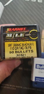

What ammo are you using to get 1-1.5 moa ??
Mine does not seem to like the generic 55gr stuff.
In my 300BLK I handload Barnes110gr TAC-TX.
In my 5.56 I'm using handloaded 55gr V-Max
