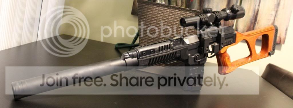

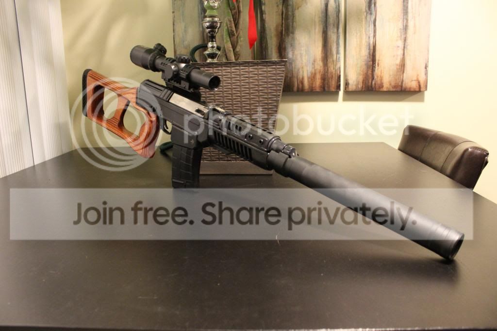

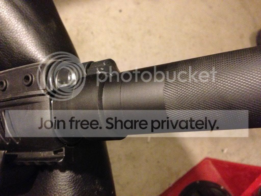

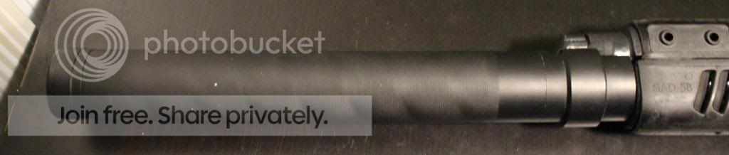

Here is my new version of VSS "Vintorez" clone that i built using a non-restricted CZ 858, this time i tried to look after few issues i had with the first model.

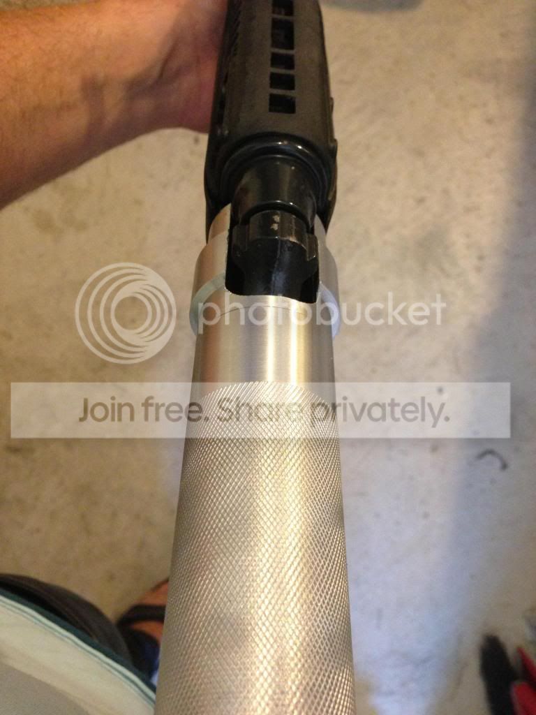

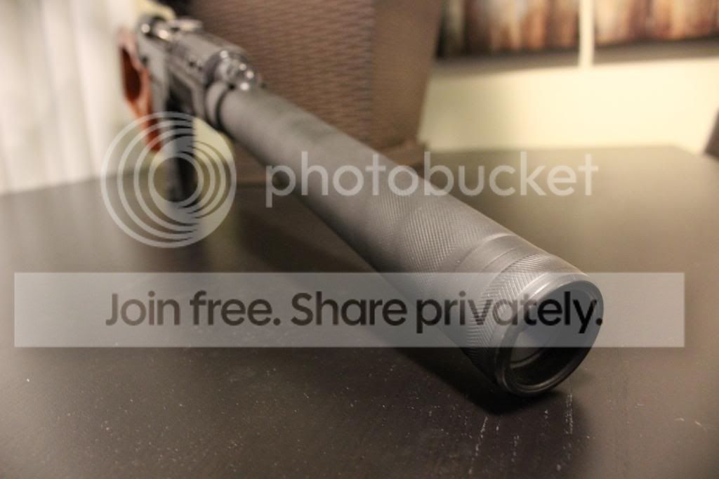

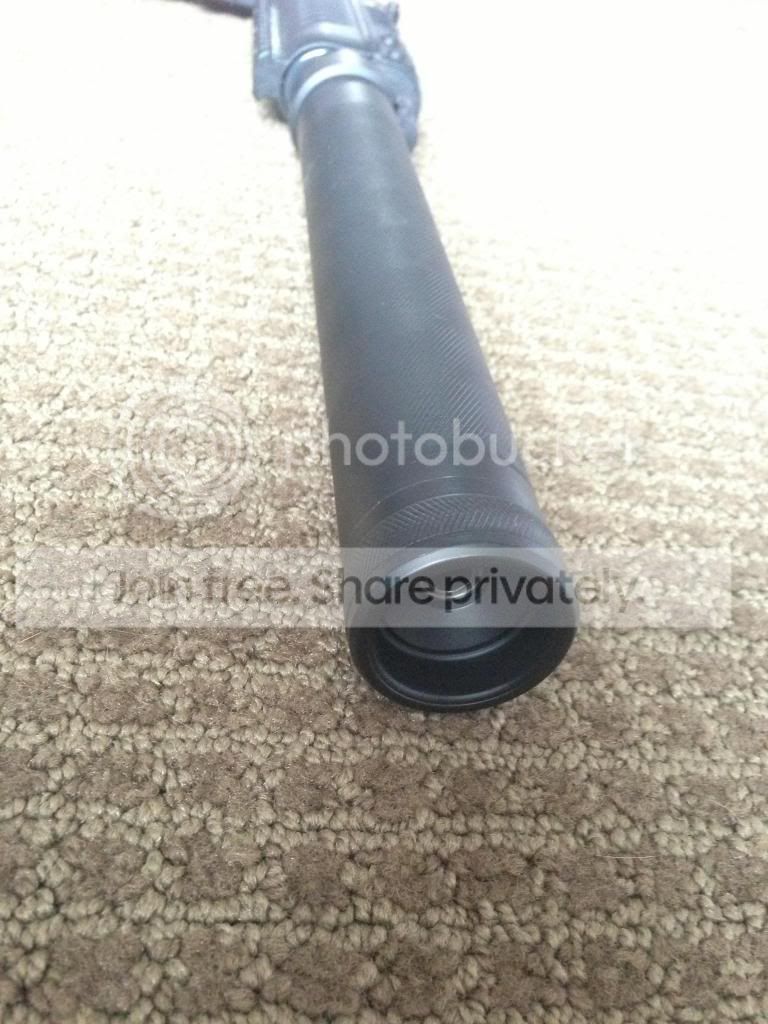

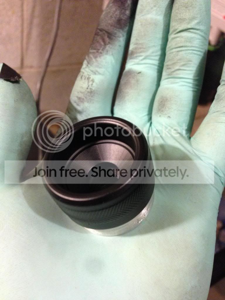

Custom aluminum Barrel shroud is machined in 3 pieces and is more solid then ever, although still light weight. Short inline brake throws the "boom" forward making it easier on the ears.

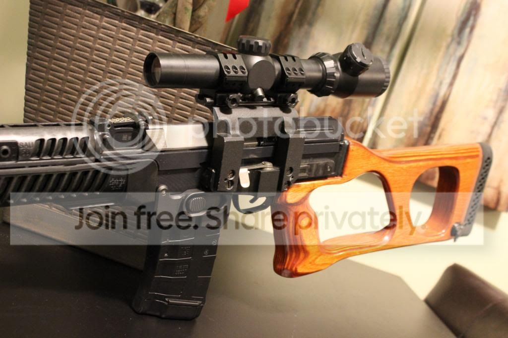

B&T Mag Well adapter is also a good improvement, it allows me to use 10rd XCR pistol mags and looks more like the original VSS.
I also change ergonomics on the stock and added a recoil pad, increasing comfort dramatically.

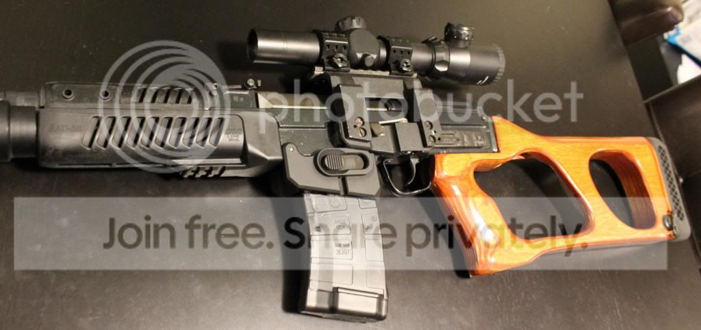

The scope im using for now is 1-4x26 IOR Valdada.. on a "BP-02" Centered Side mount supported by "west rifle" side rail.
Most of you probably wondering whats the mag im using..
Its a custom Hybrid mag i made by inserting a XCR 10rd mag into a bottom part of a 20rd Tapco mag filled with epoxy
i would like to note that ghe XCR mag was not modified in any way, so perfectly legal.. it is very solid, locks in tight, looks great, i like it.
Im currently working on cheek rest/riser, shell deflector, and also thinking of putting a longer rail to be able to move the scope a bit more forward. I'll will post the new developments later, Here is what i got so far.
I know some will like it, some will hate it, let me know what you guys think.
