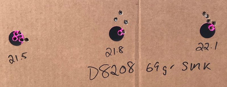

Started on some D8208 loads today. 2.260 COL, Sierra 69 gr SMK, IVI brass, Dominion SR primers, in a Mossberg MVP Predator.
5 shot groups at 100m. 21.5 gr, 21.8 gr, and 22.1 gr, from left to right. Kinda rushed the 21.8 group so the size is probably me. Groups were 5/8", 1 1/8", and about 7/8".
Very happy with the initial results. Didn't chrony, no idea of velocity. Some slight flattening of primers on all loads, but no ejector marks or other pressure signs.
