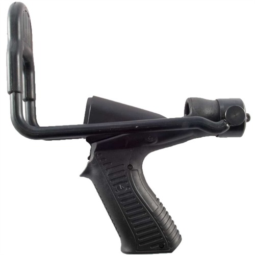

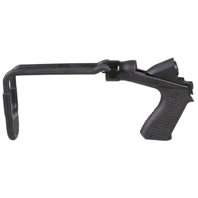

Will the Blackhawk folder, mounted on the 12.5" Grizzly, still be over 26" folded?
This guy:
That Knoxx folder stock sucks. It's not really compact and offers no cheek weld.

Another question...
This guy:
It is 26.001" folded. Edit: But................................ It compresses
You could make some kind of pad that goes on in the unfolded state. I have an ATI folder in the mail, I'll see if I can put a silly extension to get 26" on the 12" (it will be aboot 25" out of the box).
I am OK with having a detachable cheek piece for a folder, if the bear won't give you a minute to stick it on, go without.
You can always have a bolt sticking out of the front thru the magazine cap to increase length, call it a sling adapter.
I'd rather have another 4 or 5 inches of length with a collapsible stock then the extra 4 or 5 inches of height that the Knoxx folder gives......
The uncomfortable cheek weld could be lived with but the way the stock sticks up above the receiver when folded is counter to the goal of a compact and handy shotgun.
If I have an 12" Grizzly with an M4 style stock with 11-14.75" LOP, perhaps I could cut 3" offthe "buffer tube" to get 9-12.75" LOP. 9" LOP would be 27" OAL by my calculations.
So compressed would be 27" OAL, extended 30.75 OAL with a 12.75" LOP. It is very easy to go from fully closed to fully open on an M4 stock. I'll know better when my new stock arrives in the mail.
