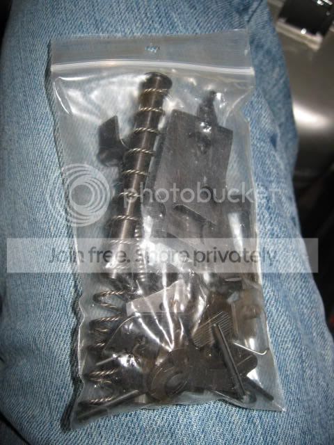

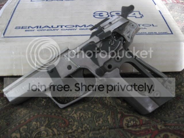

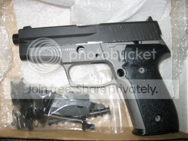

When the pistol arrived, it looked like this.
Here's a better view of the internal parts.
Okay, first problem was that nothing fit...not surprising right, after all he did say that they required fitting. I "assumed" that meant that parts where fairly close to the sizes and shapes they needed to be, but nope! (Keep in mind, these are only my experiences, I'm obviously not a Gunsmith and I'm pretty broke so my tool budget was almost non-existant)
- The hole for the trigger pivot pin in the frame was too small, so I used a drill bit to get the hole almost right, then used a NC tap to take a little extra metal off around the hole, finalized it with a reaming using the drill bit.
- The locking block was slightly too wide to settle into the frame, used a 10" single cut flat file to take some metal off.
- The slide stop lever was too thick to fit beside the locking block and the lever wasn't bent properly. I used the file to thin it out a bit and some gentle force over the edge of an old running shoe to put a better bend in.
- The bearing plate for the decocking lever wouldn't fit into the frame properly because of slag/casting flash in the pocket. I should have done like others did (in the DAC394 assembly thread) and machined the pocket out but I'm poor, so instead I used a $19 Jobmate Rotary Tool (2 weeks ago) and $30 500 piece accessory kit (last weeks sale) to chamfer the edge of the plate around the ridge in the pocket. Still worked 100% but isn't as pretty.
- Trigger bar isn't shaped properly where it rubs on the hammer pivot pin, it's not bent properly to fit into the frame smoothly and seemed kinda rough. Flat file, steel wool and polishing tip on rotary tool to smooth it out.
- All internals needed to be filed/grinded/polished and trial fitted, then metal removed again. LOTS of trial and error.
- Hammer needed tons of work to clear the plastic hammer stop block, Needed lots of filing to make hammer/sear engagement work. (Thanks to "Joe-Boy" for the help in the other thread)
- There are 4 ridges in the magazine well that need to be removed if you plan on using Sig P228 mags (and you will, see "Range Day" section for details) Sorry guys, the only way you're gonna remove these properly seems to be a file and it's SLOW.
- When the mag is inserted, it rubs on the trigger bar and binds the trigger pull. I filed the magazine sides down, they're very thin but I'd rather ruin a magazine than make the trigger bar too thin. It's still causing some resistance on the trigger but I'll live with it for the time being.
- Slide and "firing block" were full of filings. Disassembled and spent quite a bit of time on my hands and knees looking for safety block spring.
- The barrel doesn't clear the locking block on the frame. This one REALLY threw me for a loop but it turns out the feed ramp on the barrel is either way too long or the locking block is way too tall, so I shortened the feed ramp. File, then fit, then file then fit...
Those were the main issues I had, but tons of other small ones along the way. My fingers have been sore, swollen and painful for the last week from assembling then disassembling, rinse and repeat. I seriously feel like one of those old farts with chronic arthritis in his hands.

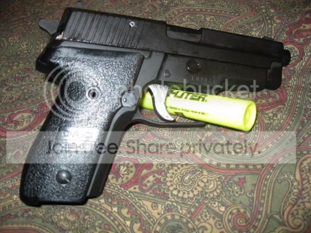

Here's what my frame looked like two days ago... Excuse the bad lighting but I was going for the "highly polished steel look". I determined it showed scratches too easily and was starting to rust.
So yesterday I decided I'd use Silica Ceramic paint (1200 deg header paint) and baked it on in the toaster oven. Turned out AWESOME!!!! Way better than I expected. I was stupid and did ALL my parts, don't be an idiot like me and paint your internals:p
Here's what I ended up with

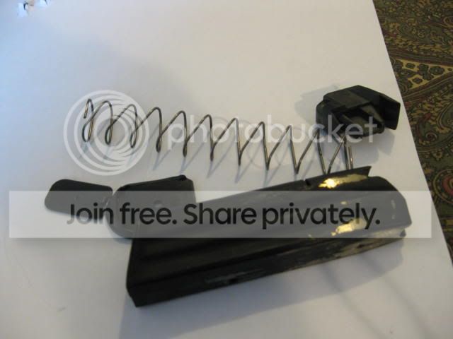

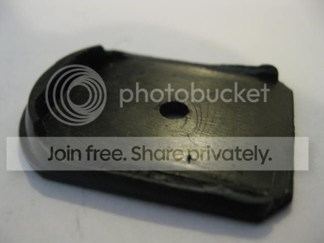

The lips on the plastic baseplate of the Dlask mag broke, so now I'm forced to load one round at a time, by hand, and the slide isn't sticking open after the last shot (obviously)

Thanks. I've shown it to a couple folks and they think it looked good, most thought it was factory finish. Once I tell them what I really used, they screw their faces up and try to nit-pick on the little imperfections (ie: where I touched it in between curing cycles, the scratches from where I slipped with the screwdriver trying to insert the mag release locking "nubby") I just figured it was cheaper than parkerizing or bluing, better than just regular spraypaint and stops the rust.
After curing it has a "chalky" feel almost like a powder coat. It discolours your hands at first but now the places I touch a lot (ie:slide) have worn smoother and don't leave residue on my hands.
Like anything else though, it's going to require an on-going evaluation and a bit of longer term testing before I try using it on anything else. Seems durable enough though.
