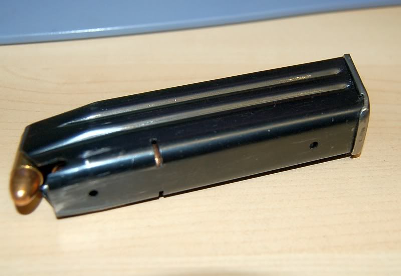

I just ordered some spare mags from Dlask for my 394. It sounds like they still have about a dozen left. If you can get past the plastic base pad issue then they are likely the cheapest option for these guns... (why did I just bother grinding out my mag well ridges :rolleyes: )

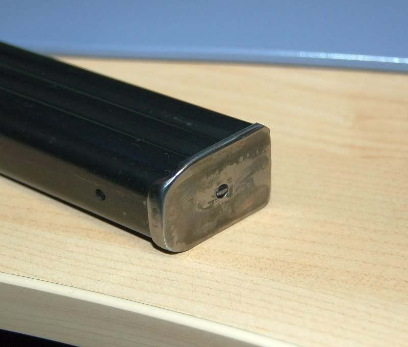

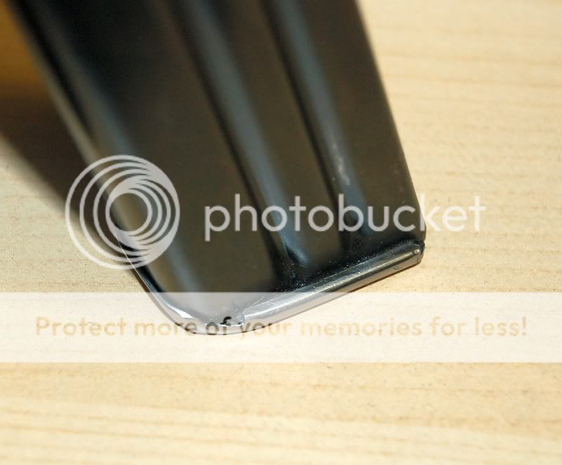

My base pad is starting to crack so I'm going to give a try at fabricating a sheet metal cap with a bonded on rubber bumper. Hopefully I'll post an update if/when I make some progress. My plan is to give TDSA a try this spring with my DAC so a full rig will be needed.

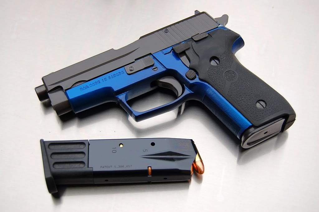

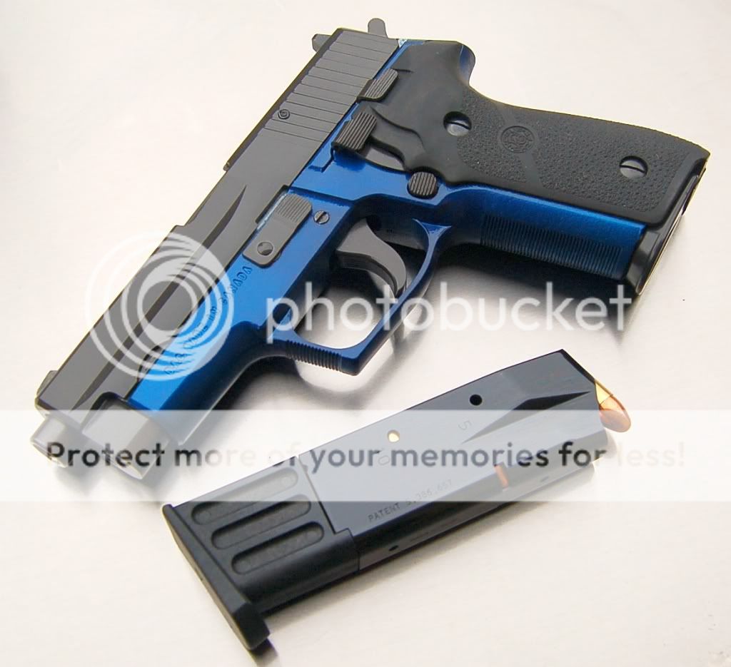

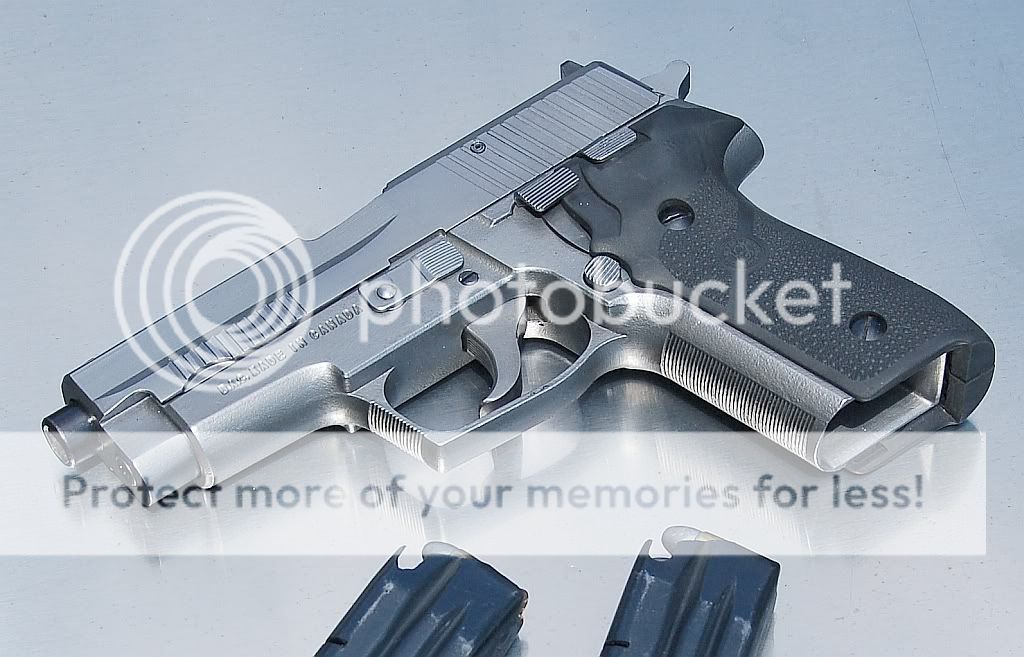

I played around with the image in IrfanView to enhance the color a little and compensate for the overcast day... The guts aren't in it as evidenced by the trigger in the first pic.
I used Duplicolour Metalcast paint in Blue and Dark silver over a bead blast finish. It's not quite the result I was hoping for and looks more like paint than anodizing. I had a can of base coat but didn't use it thinking the bead blasting would provide an adequate base. After an evening in the oven and overnight to dry I got uppity to assemble it and see how it looked. The finish is still soft and I marred it up a bit installing the front sight. I hope it hardens up as it wont last long as is :(
I may just strip it and park it as originally planned but I wanted to try something different and had the cans around from another project that never was completed.
MB
P.S. Yes I accidentally picked up a 226 mag instead of a 228 mag :redface:
